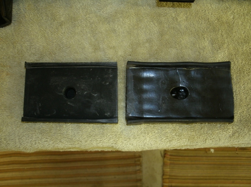

In anticipation of my '68 being released from paint jail soon I was reading through your assembly post today. I had a similar experience with the rear end being out of kilter. After pulling it all back apart I could find no cause other than the housing had slipped on the polyurethane spring cushions. I wanted to stiffen up the shackle flex so I elected for an aftermarket polyurethane kit. In addition to the shackle bushings, I also installed the spring cushions but left the front spring eyes rubber. Until this build I had always used GM spring cushions and never experienced any problems.
Enclosed photo is what I found upon disassembly so I elected to purchase some of GM's finest as they are still available, part number 3930052 for multi-leaf springs. The aftermarket cushions do not have the molded in metal support for the spring pilot pin like the GM cushions do. I don't know if the aftermarket cushions were the cause or not but after 4 years with the GM cushions the rear end is still located perfectly.
Your problem could be something entirely different. Just something to check. I've never read or heard anything bad about polyurethane spring cushions but mine moved. Nothing else but the cushion was changed in the assembly to fix the problem.

Thanks for posting that Dennis. I'm going to check that on our car and will likely find the same thing. Do you think any of the aftermarket poly cushions have metal inserts?

I don't know, my only experience with aftermarket cushions. These were Energy Suspension pieces. I've never had a problem with their other components. I'm wondering if the poly cushions just don't compress as much leaving the pilot pin disengaged?

I called Ames and found out their spring pads do not have metal inserts--neither the rubber ones nor the urethane ones.
I think we'll go with urethane ones unless we can find some of the OEM ones. We have to remove the spring "U" bolts anyhow to install the traction bars. I hope we find the same thing Dennis did on his. That's an easy fix for the crooked rear axle.
