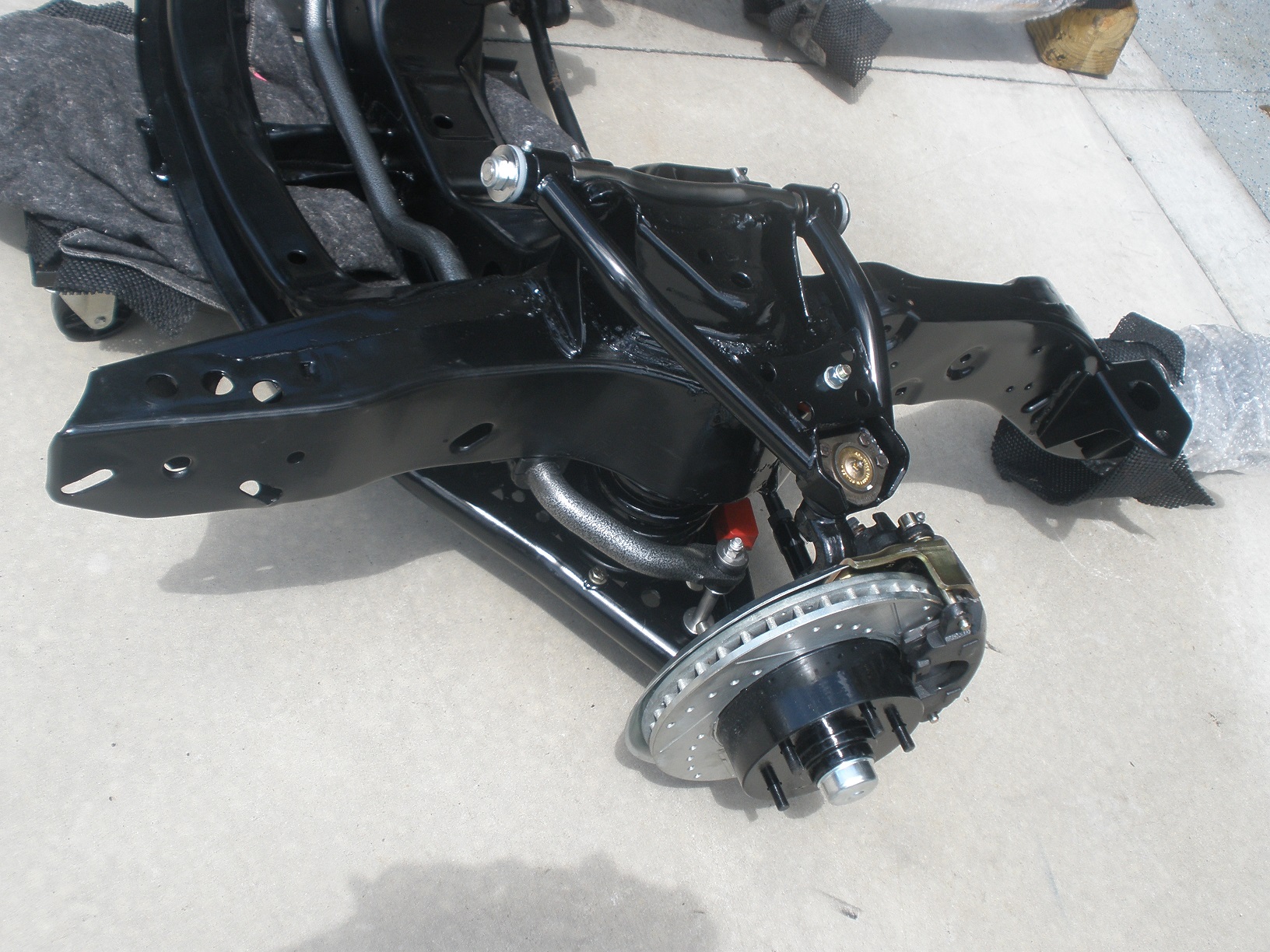

Goose is correct. Only three bolt holes on the subframe. My 69 came with PS and as you can see from my subframe pic there are only three holes to mount the box on it
