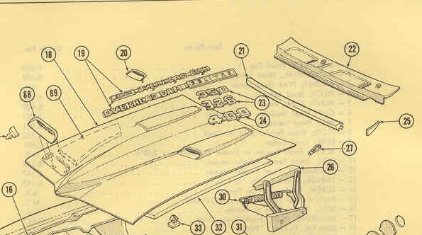

There are two wedge shaped foam seals which install under the cowl panel. Item #25 in the illustrated parts manual. What is their purpose? Can anyone tell me the placement of these seals?

Parts manual illustration.

They adhere on the underside of the cowl on the outer part of cowl about 3-4" from edge. Keeps water out.

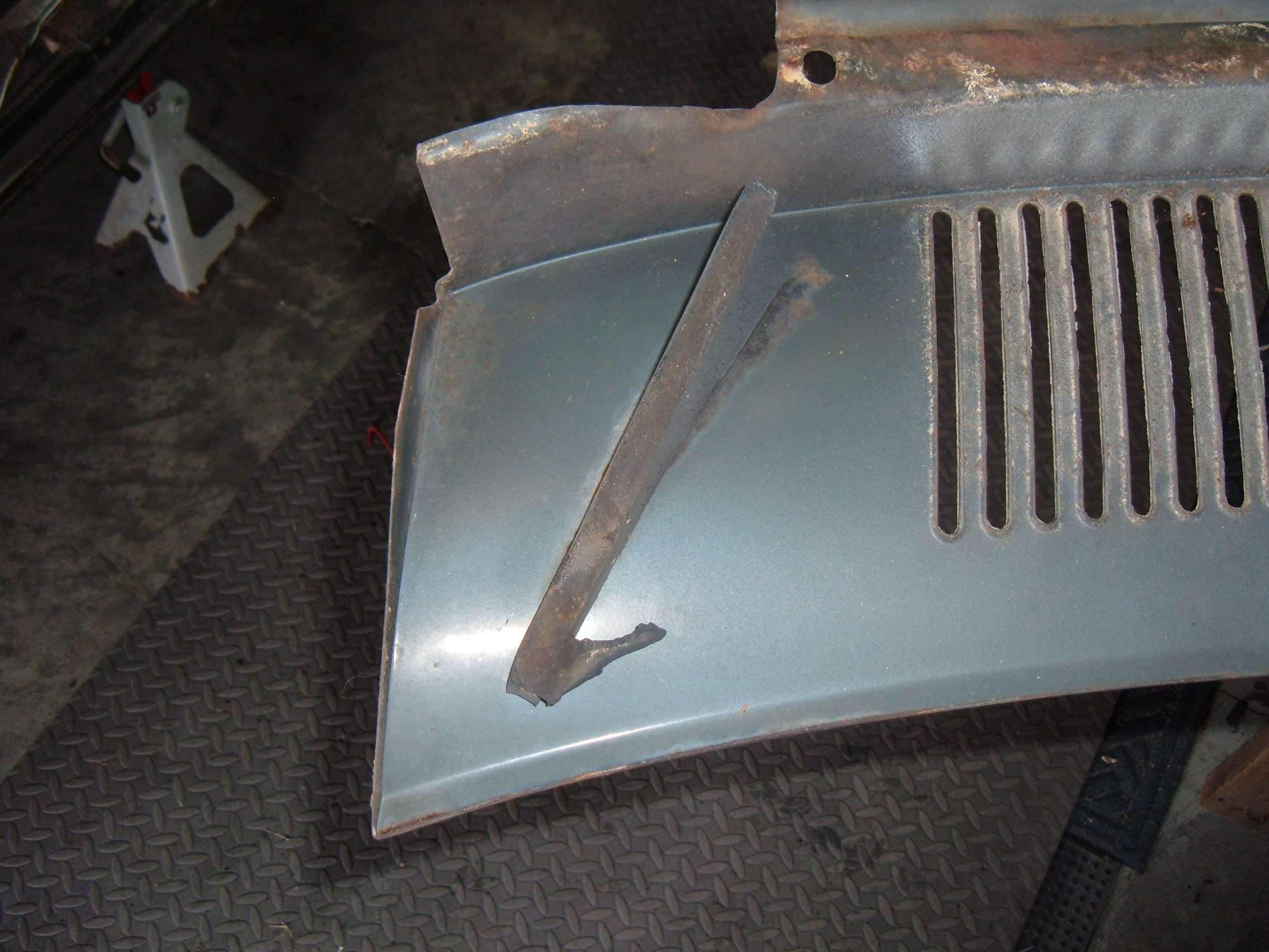

Cowl

Here's a pix of when I was taking mine 68 apart.
