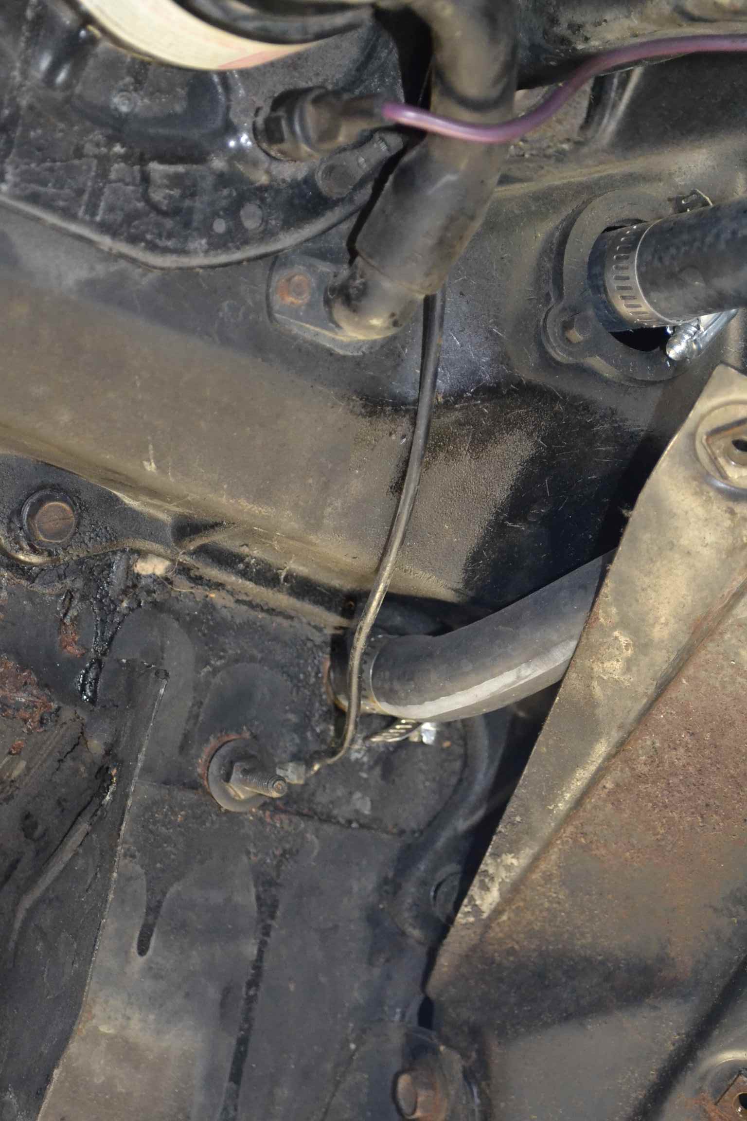

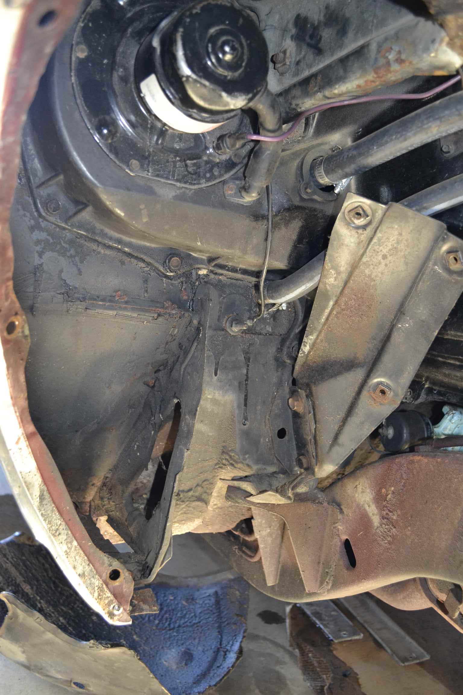

Does anyone have an easy way to get the blower motor out? i need to check if it even works. also if you have any pics please post!

Two choices.
1) Remove the hood and passenger side fender.
2) Cut a large flap of metal out of the rear of the passenger side inner fender. There are old posts here with photos. The advantage here is that you can make is so the flap closes again in case you have to pull the motor out again in the future.

Does anyone have an easy way to get the blower motor out? i need to check if it even works. also if you have any pics please post! I would agree with Salmon. The previous owner of my car cut the inside wheel well. Here is a link to the old thread Salmon mentioned: https://firstgenfirebird.org/forums/ubbthreads.php?ubb=showflat&Number=123734

I went thru this not long ago.... it wasn't the end of the world taking the fender off... I ended up replacing the inner fender well while I was at it..... I'm not sure if I had it to do over id do it like that though... I would cut the access door into the fender well and just tar back over it after.....

What do you mean by make a flap? like put a hinge on it once i cut it? Two choices.

Also does anybody know how to test these blower motors? i dont know if its my blower my blower relay or what. the engine bay harness has a couple of cuts here and there so im not sure if it is all hooked up

I thought somebody installed a hinge. Others just cut 3 sides of a rectangle or square and then bent the sheet metal out and then back again. It's been a long time since I saw the photos.
For testing, just connect the single terminal to a 12 V power source and clip a wire from a negative source to the outer flange to ground the housing.
