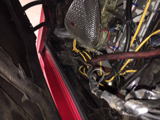

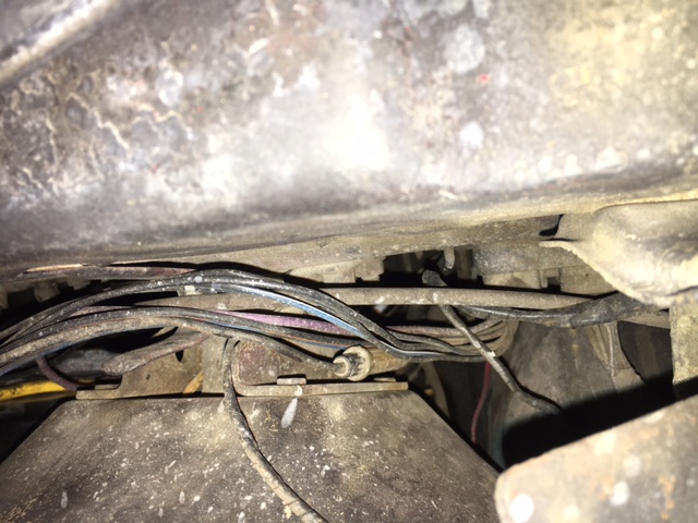

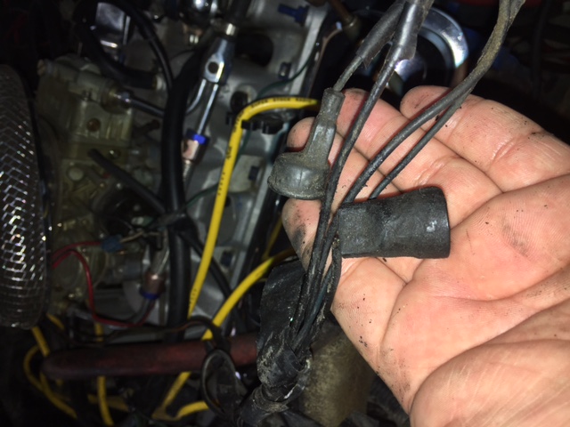

Ok my 68 has the harness a little cut up and a couple of non connected wires. Ive looked up a schematic but just got lost in it can you guys help? the first one is a green wire that been cut from the motor blower relay cant figure out where it goes there is also about 3 wires that come out of the firewall that are taped up. Any helps is really APPRECIATED!
We need more info. Like the colors of the 3 wires out of the firewall. Are those 3 wires long enough to have been run to the passenger side via the wiring channel over the tranny tunnel? If so, then 1 of those looks blue and I was leaning toward oil pressure switch. If 1 is black/orange then that's for the blower motor.
Unfortunately the 2 items in the 1st photo are foreign me a '67 owner.
