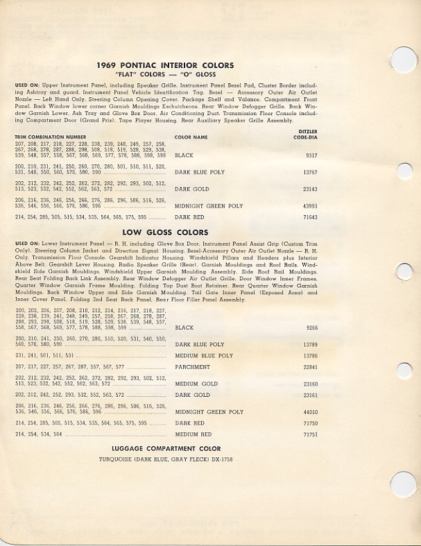

I want to repair and repaint the steel portion of the dash on my 69. FAQ's here didn't really help. Online searches didn't either. However I found one site "old ride.com" that has paint codes for the 69 Grand Prix. I imagine the Firebird would have used the same color and this site does show the interior paint codes in Lucite, a Dupont brand. Does anyone know if the Firebird and Grand Prix dash paints are the same?
Thanks
Doug
Here is the '69 paint code sheet. Not sure if this will help:

Here is the link to the same thing just in case you need it. http://thefirstgensite.com/library/paintchips/1969-pontiac-pg02.jpg

My conclusion looking at this sheet is that all Pontiac models used the same choice of interior paint colors. I appreciate you posting this since the paint shop I use deals in PPG paint and they probably can pull up the formula from these codes.Thanks!!

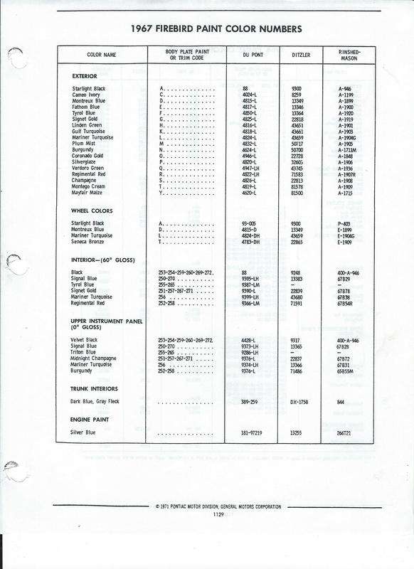

Is there something like this for 67 somewhere ?
Posts: 6,158
Likes: 51
Posts: 6,158
Likes: 51
Originally Posted by Jv225

Thanks. Do you know if there is anything that breaks down what gloss level goes where like that 69 paper does? Hopefully my interior will be getting painted in the next few weeks. Happy Thanksgiving
