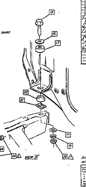

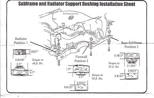

Hope this helps you out. It is pretty easy just put them in like the pic shows. On the second smaller pic, position 1 is what you are looking for.
