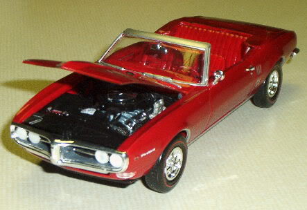

FYI, The picture is a plastic model I built to match my car several years ago.
