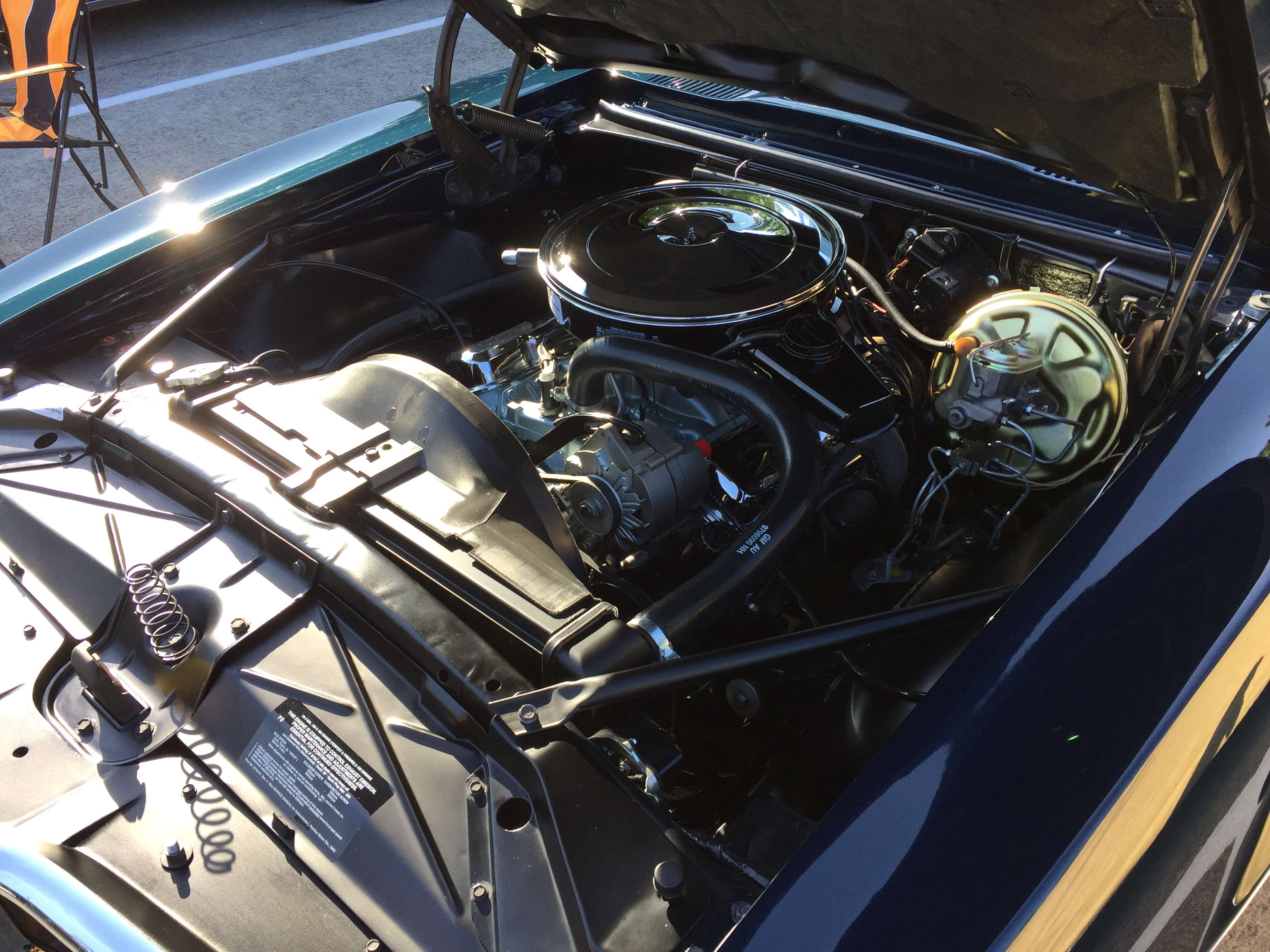

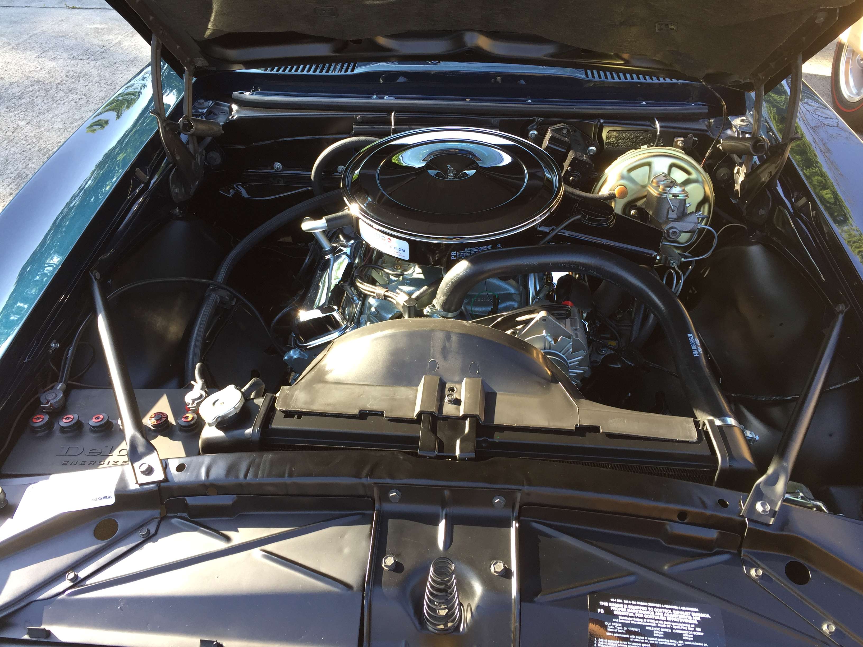

I have only heard Firebird 400 HO had #16 heads. Not sure about the #216 head but Wallace Racing does list a 16/216 for 68. I would have thought F 27 7 Jun 27 67 would be for a 67 dated head but Wallace Racing shows as 68 16/216 head. I would like to hear from others about this and details about the #216.
Here is a couple of photos of my engine dressed out according to my research and should be pretty correct.

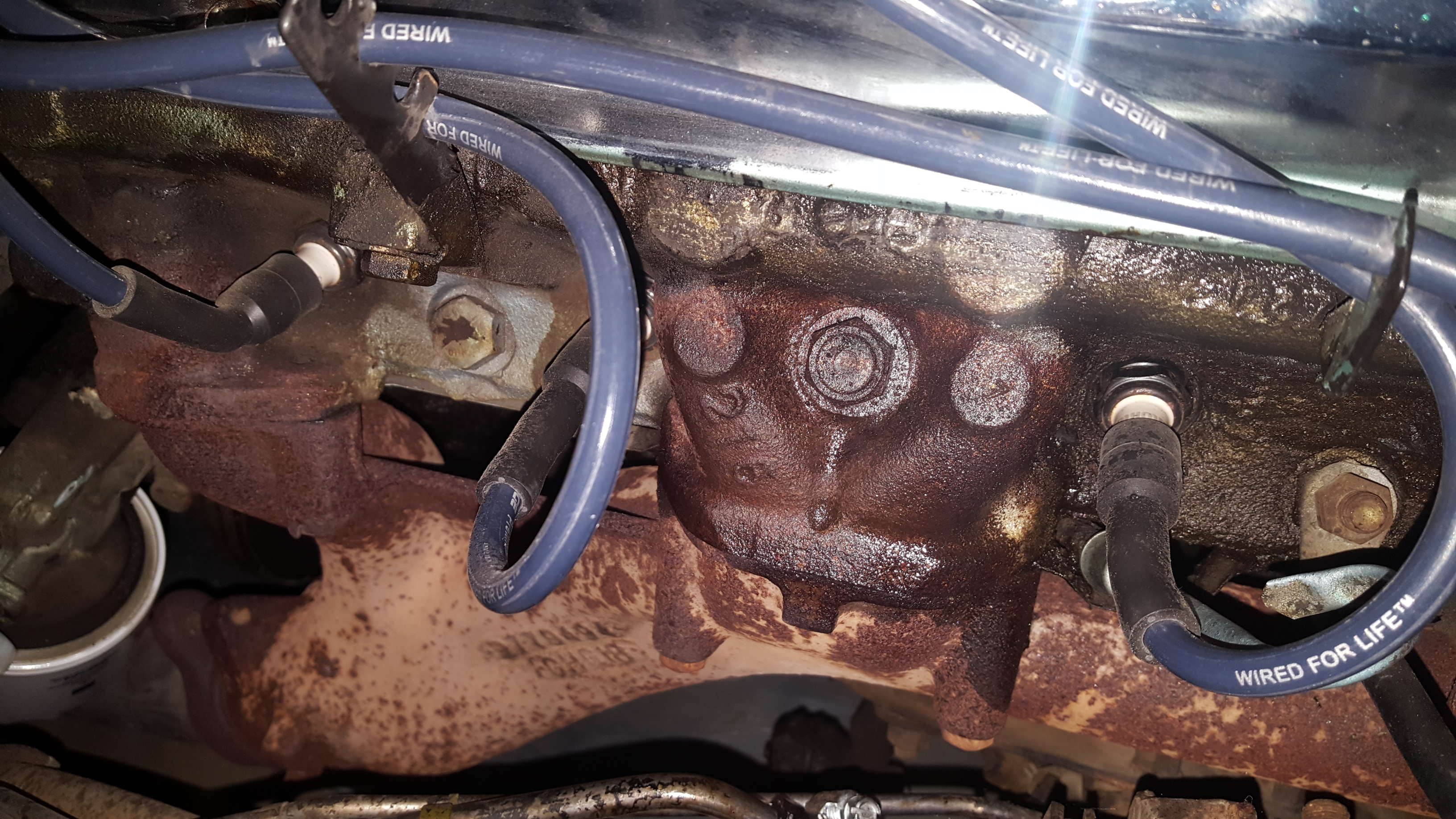

I would love to here more about this heads also

You look to have the correct Long branch Exhaust manifolds too. Awesome!
