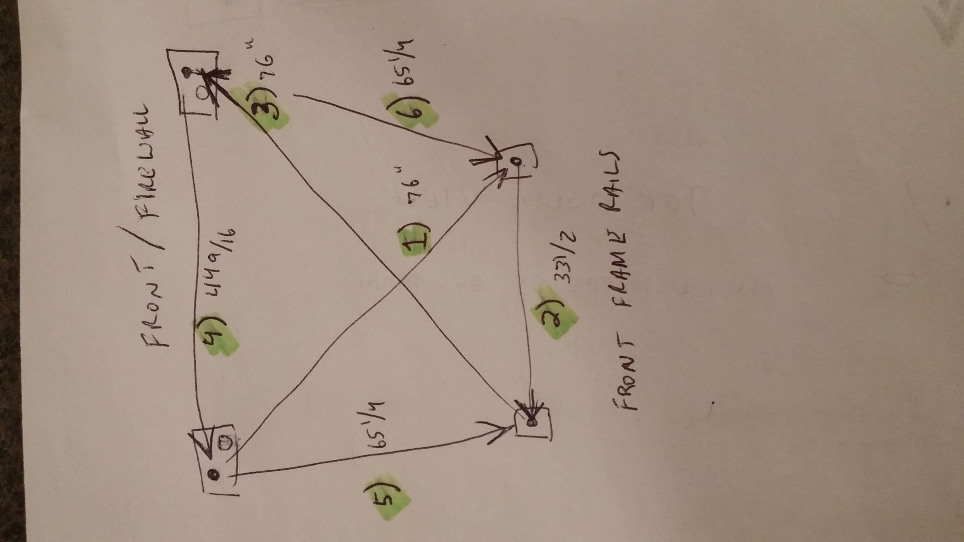

My son and I cannot figure out why we are failing to get a square and equal measurements between the areas identified on the attachment.
That 64 5/8" measurement is messing with my head! No matter what we do or how we adjust, that ******* measurement persists!! lol The Camaro "jiggy" plan identifies both measurements as 65 1/4. We cannot get there the way we are measuring.
Are these measurements NOT supposed to be as illustrated?
All guidance accepted and welcome!!
Wade

I am relaying my experience of cabinet making on how to to square things up, should apply here. I would adjust the frame frame back to get the 64 5/8 measurement down to 65 1/4. This will throw off the the two 76" measurements such that one is too long and one is too short. Then take you will need to push/pull the diagonal probably with a hydraulic ram but maybe some threaded rod will work. It will likely bounce back so take that into account. Then check all the measurements again as things probably moved (like the subframe). Repeat.
Have you checked your subframe and the body itself to make sure it isn't tweaked. If one of those is tweaked, doubtful you can get it aligned.

The picture is for the body jig itself, not the car. The firewall to the front frame rails. I believe I understand your explanation but, these are flat surfaces: Picture attached.
The measurements listed previously are what I'm getting for body alignment pin measurements.

Look at the problem as if it was a parallelogram. It's technically not but the principle will apply. So once you set the distances of A, B, C and D, you need to adjust the sides to bring the diagonals to become equal. In this case, you slide both A and D to the left while maintaining the distances between A/B and C/D. At some point the diagonals will equal and you stop. This will take some iteration but should work.

Understood. But all other measurements are accurate except A to B. If I adjust for A to B then all other measurement points are affected.
These are accurate right now: A to C B to D A to D B to C C to D
I don't understand how A to B can be inaccurate given all other points are accurate to a precision measurement (a hole punch) using a tram gauge. It's mind boggling. I'll try a few variations using your principle and report back.

Build a frame cart with mounting points in correct positions. Put panel on cart ... weld...what's other measuring your doing. Use Fisher mount measurements if you have to.

As illustrated by the pictures, I'm trying to build a frame cart. The last few posts were related to the cart / jig and not a car.
These measurements derived from my Fisher manual.
Clarification post: Is there a specific sequence of measurement? Tonight my measurements (sequenced in the attachment) came out less than an 1/8" off on the body cart pin alignment, which is acceptable,yes?! Last night I measured using a different sequence and found myself 5/8" off. Big difference.
Posts: 6,758 |
Sorry, my bad ... failed to read your post correctly. Be as close as you can because your error could propagate. Let me think on it a bit and I will get back to you.

No problem. I recently did the same thing. The question really now comes down to this: If I split the difference between the 3 respective pins, it would be 1/32 of deviation at each pin. I'm not even sure it's worth the additional thought. I'm going to re-measure one more time tomorrow to ensure I obtain the same measurements as I did today. I will update once again tomorrow.
The sequence of measurements seems to matter.
Also, I realized tonight that the tram measuring tape has some slop when opening and closing. That may have contributed to the inaccuracies last night as well. NEW TOOL = learning curve.

You provided that to me prviously, which is what I used. The body cart is already welded up / assembled. The tram measurement issue I'm dealing with is strictly related to the 5/8" alignment hole pin placement / location. once the pins are welded on the body cart is complete.

Learned two things today:
1. The measuring ribbon inside the tram is sloppy. All measurements must be measured by fully closing and re-extending the tram / ribbon.Sloppy by a full 1/4". 2. The tram sags in the center when opened to 76". This causes the tram pointer to push out just over 1/16" beyond actual presenting a false reading. Actual reading (with sag) is slightly more than 76 1/16". Preventing the sag and deviation presents a precise 76" measurement.
Lesson learned. Will re-measure the points tonight now that I've "calibrated" the tram.

I want to take a minute to close this thread since I found the problem: Turns out the 2.5" x 2.5" steel that I uses to build the body jig was not very rigid. Even though I leveled the jig, the weight of the body parts caused it to sag in the areas without a jack stand directly underneath. This was maddening and I felt like I was chasing a ghost. The jig was square the entire time. . . If you're building a body jig, ensure your using rigid steel! For those who have provided guidance, THANK YOU!! Pictures of the build coming soon. Building from the ground up with all brand new parts. What a b*tch!!
