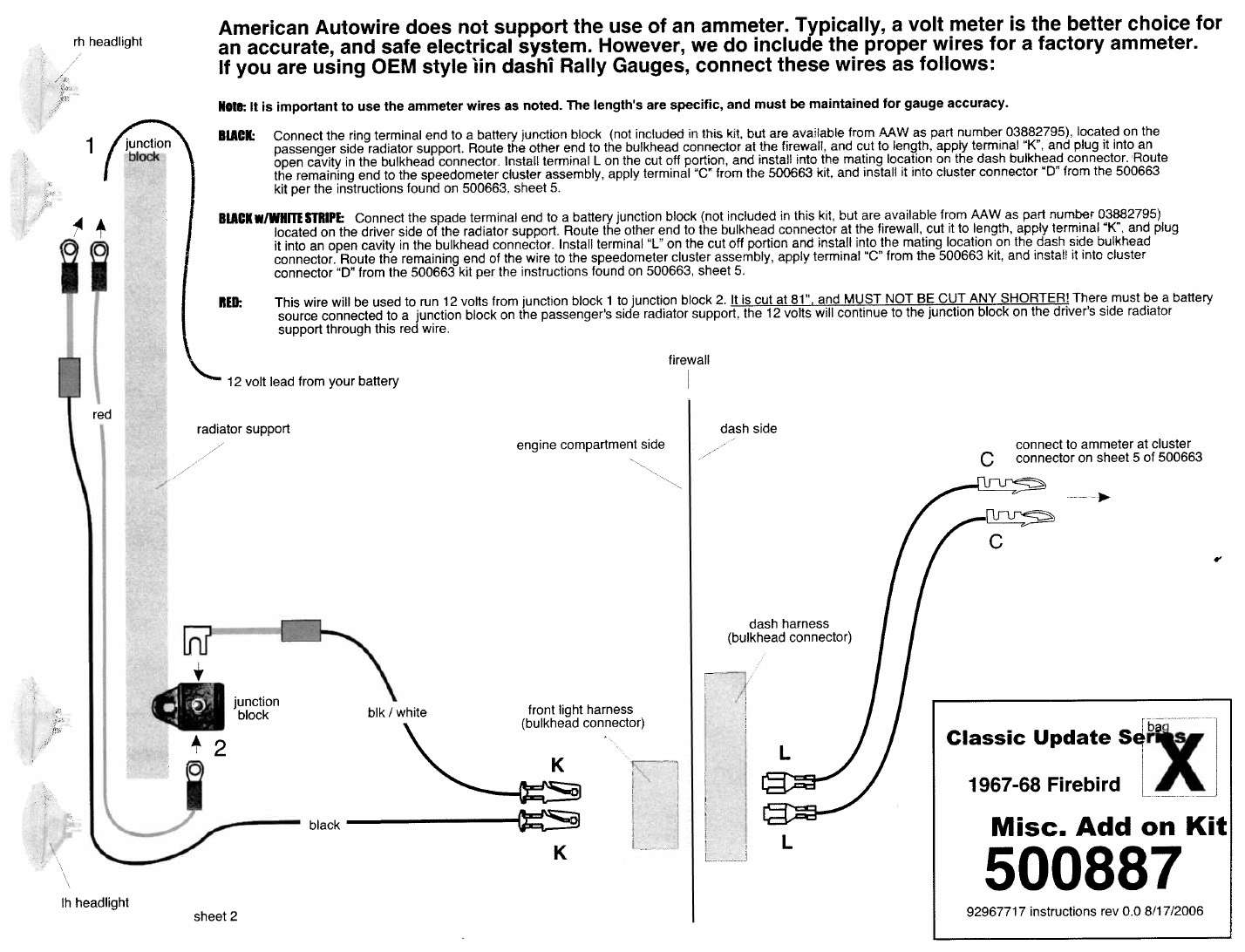

can anyone explain the procedure for this? i seem to remember you switch two wires?

Here is a bunch of stuff to look over...
Attached PDF document
68ralley_circuit.pdf
FGF - F.A.Q RallyGauageConv.pdf
FGF - F.A.Q.pdf
RallyGauge CircuitBoardConnector.pdf
Rally Gauges - Firebird Classifieds & Forums (1967_ 1968_ and 1969).pdf
RallyGauge Diagram.pdf
