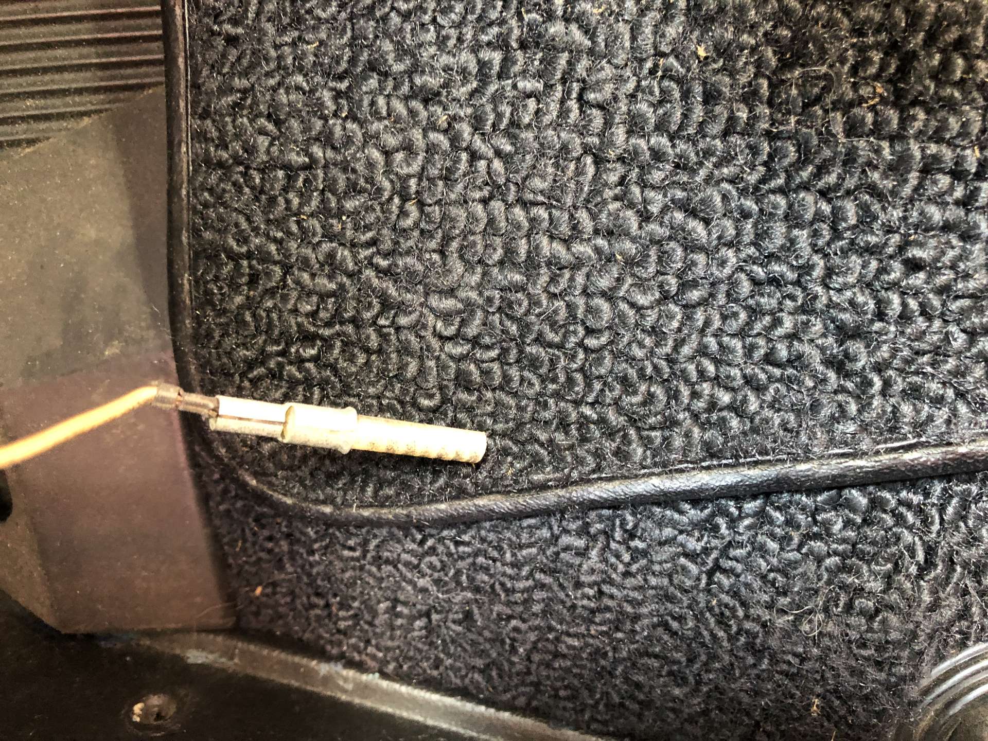

Parking brake switch or courtesy lamp, can't think of any other "1" wire circuits in that area. Does the red BRAKE lamp come on in the cluster when you press the parking brake pedal?
If not, turn the key ON and jump that circuit to ground, see if the lamp comes ON.
