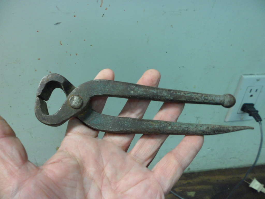

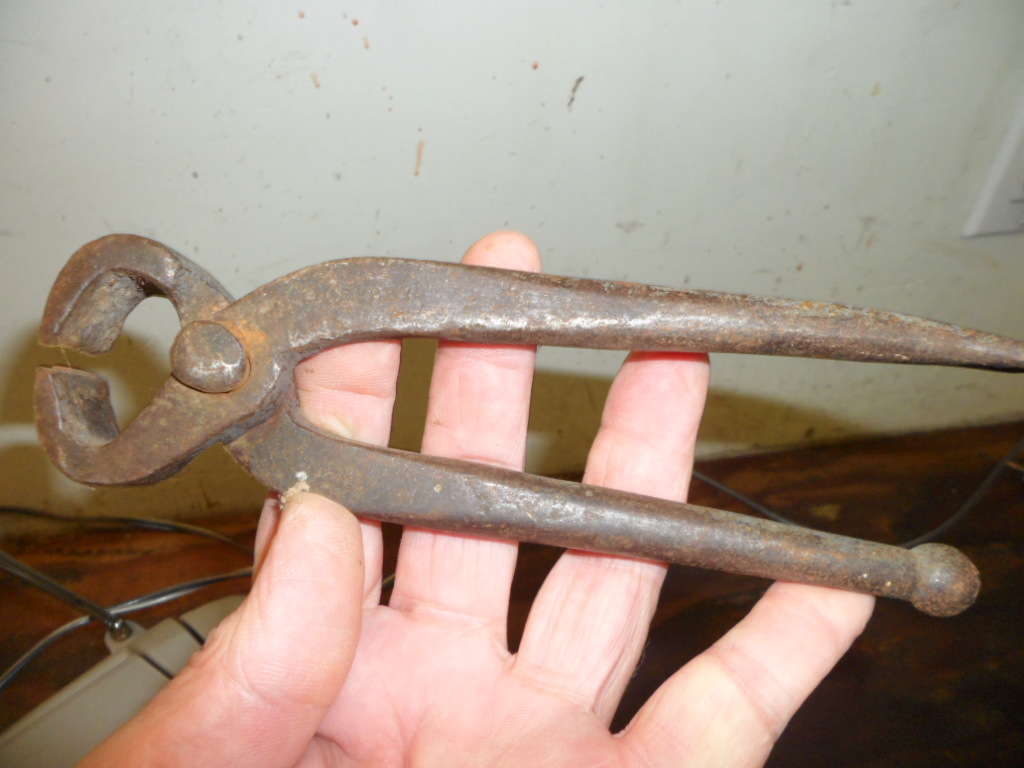

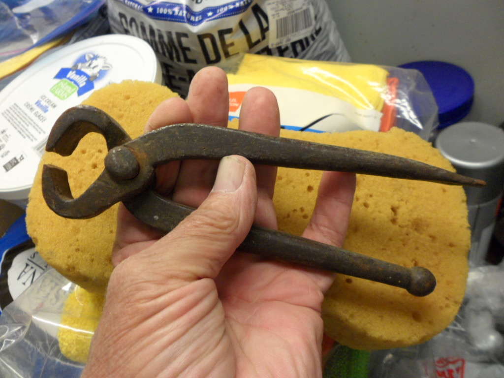

It's a plier type tool similar to one used to trim a horse's hoofs. You may be able to use a tile nipping tool if you had one. I've used them on hydraulic return lines, air lines and water lines. have to have the size for the job.
I'll post a pic of a blacksmith made tool I've used on smaller clamps

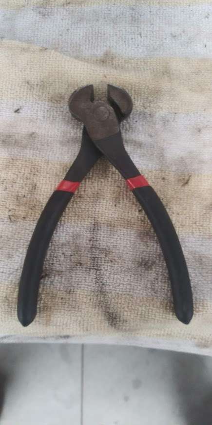

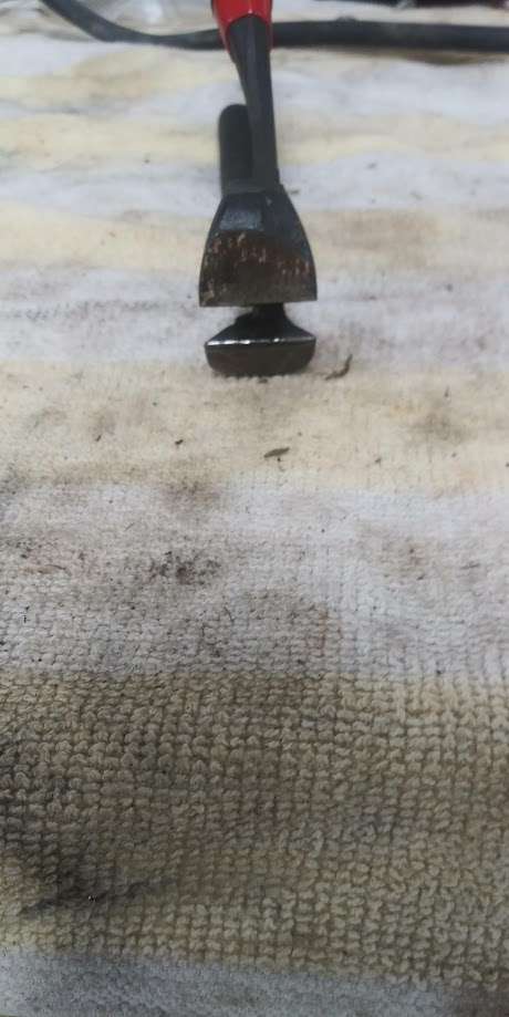

I use these

Thanks for all the ideas. I got a pair of pliers made for the ear type clamps./ They didn't have enough room to squeeze the clamp shut. The photos of tools some of you sent were right on./ Thanks!
