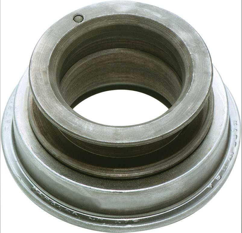

You sure your talking about the pilot bearing and not the throwout bearing?

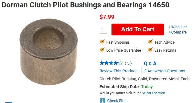

Here is an example throwout and pilot. I like the solid brass as opposed to a bearing. Pilot bearing
