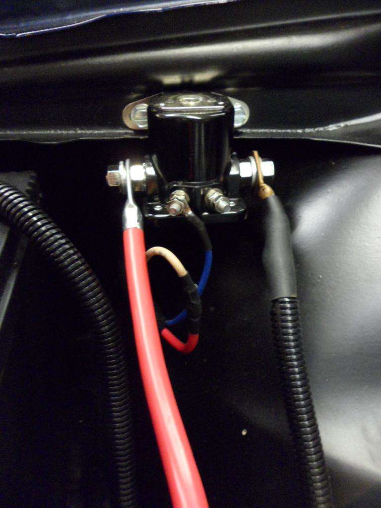

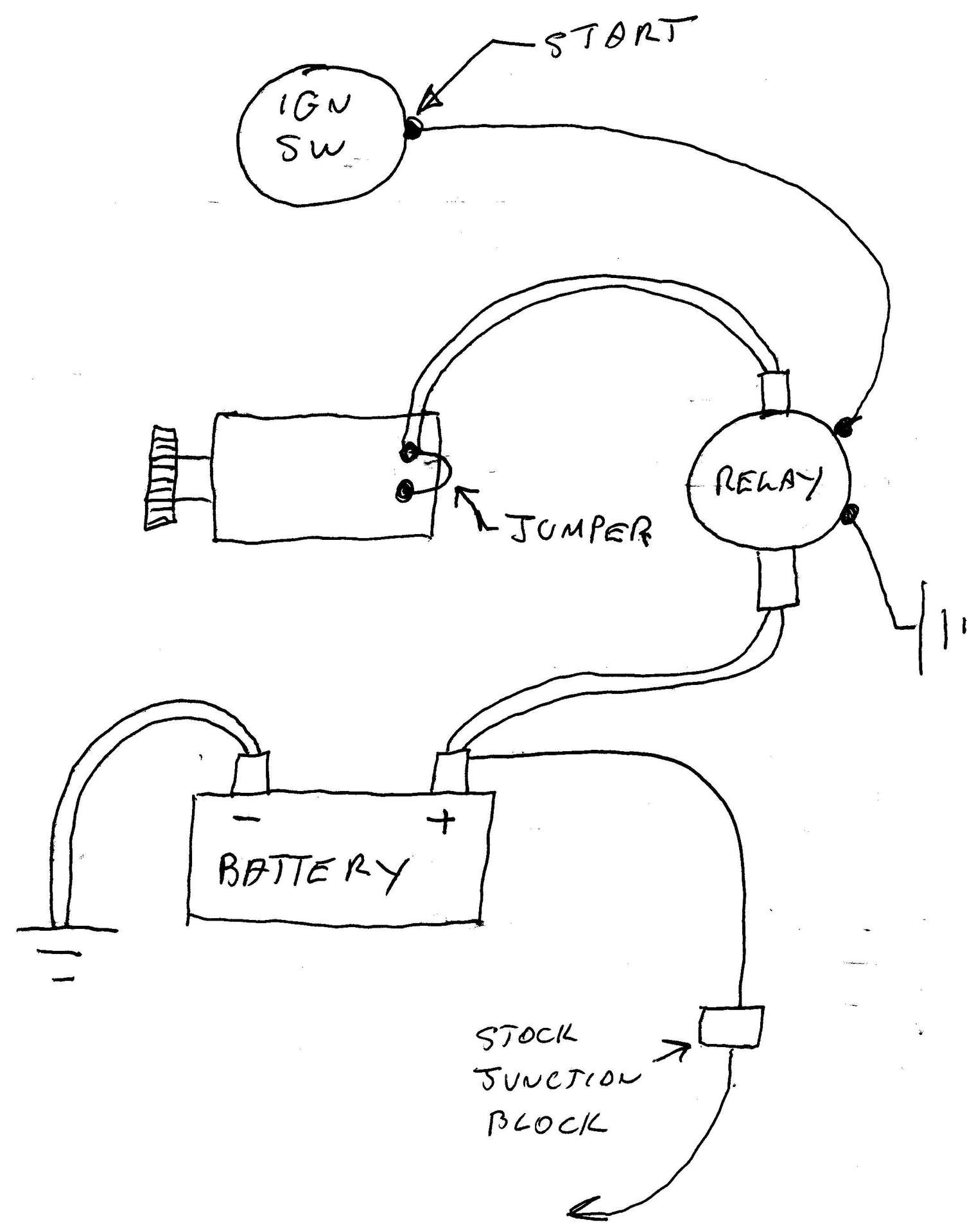

One thing I would recommend is using a Ford style starter relay, that re-routes the Purple 'start' wire away from the starter and heat. The 'start' wire from the ignition switch goes to the remotely mounted relay and the only wire that goes to the starter is the cable. The cable is only electrically charged when the key is in the start position. A jumper is included with the starter to hook up this way. See the beautiful drawing I had commissioned at Great sacrifice and expense. I have the charge wire going to mune, it's a great place to attach accessories as well. I've hooked up my remote start switch to it a few times as well while setting up the.engine. I have mine Mounted on the inner fender right near the battery, but if you are worried about originality they can be hidden.

I had considered the Ford type solenoid as an option. Would that solve my heat soak issue? It sure would be a lot less expensive. Do you have this hooked up to your mini starter?

I have that set up on my diesel mower- minus brands etc. The relay set up works fn fantastic. Bluebird is right on.

BB- Yes I have the solenoid hooked up with my Hi-torque starter. Will post pic. Been in there for seven or eight years.

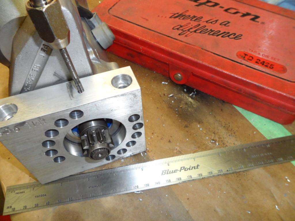

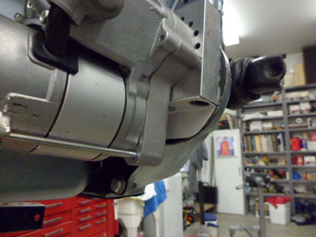

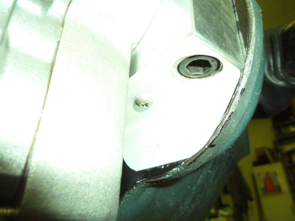

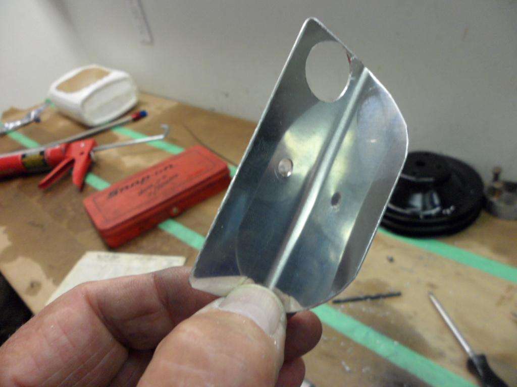

One other snag with the mini starters is the hole in the bellhousing inspection plate. The snout of the mini starter is smaller that the stock starter so the hole isn't completely filled. They say no big deal but I was afraid a stone may get in so I built a plate type cover. Will post pics.

Bellhousing-plate-008.jpg Bellhousing-plate-018.jpg Bellhousing-plate-024.jpg under hood wiring 026.jpg

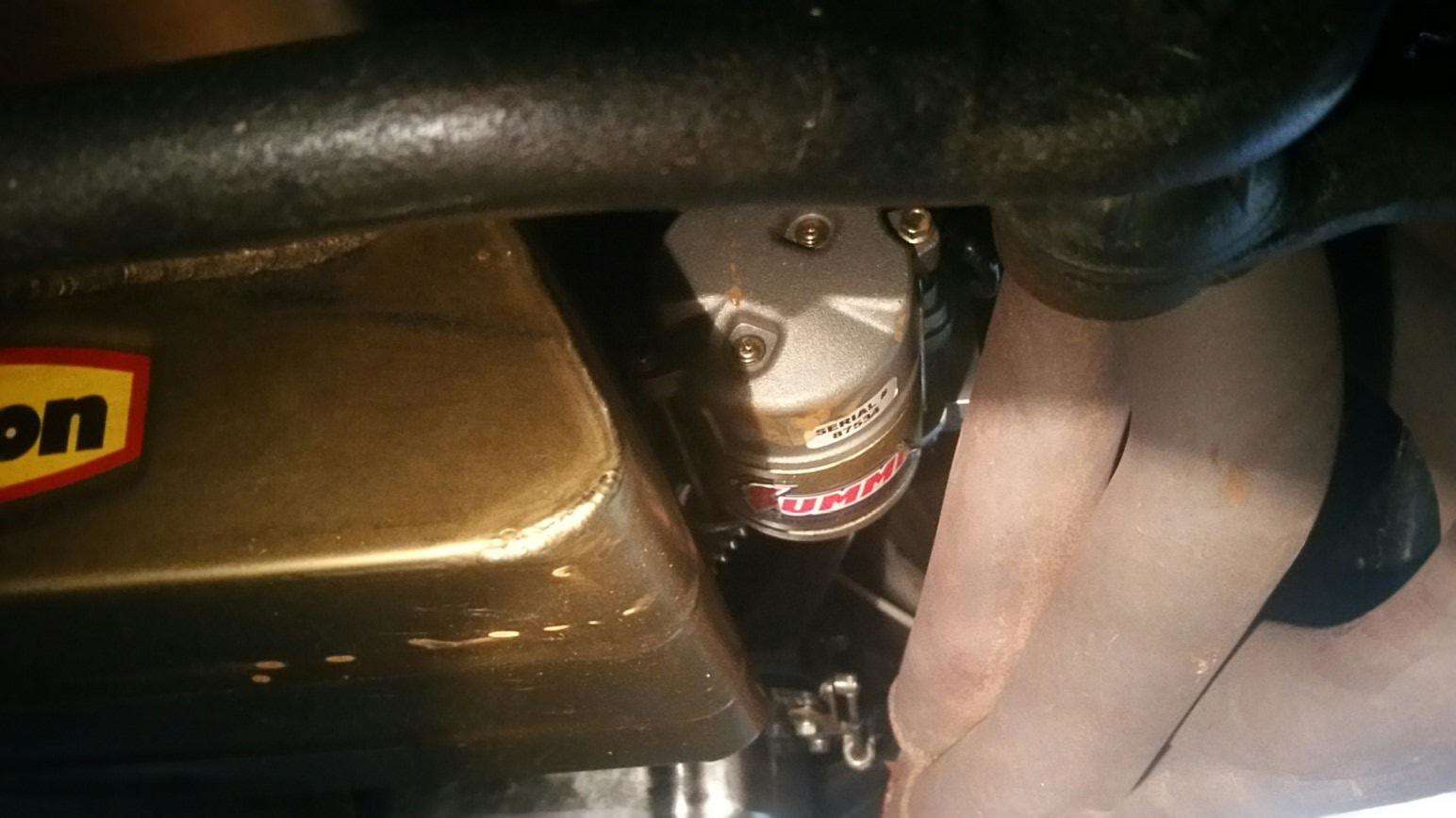

This mini starter has been in my car for 11-12 years no without any problems and has always started my engine even after driving around when it it 100+ degrees outside. Most issues are from poor wiring and grounding.
