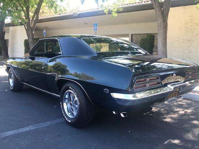

Will use the OEM look rally wheel. should i go with a 15/7 or 15/8 Plan to get Radial TA. should i do 225 60 15 or 235. any advice based on experience would be helpful thanks

215-65-15 is also an option

Given that choice I would go with 15/8" and 235/60. You're pretty tall so it wouldn't look right with a shorter sidewall tire.

69's have more room in the wheelwells than 67/68

Maybe but the shape of the rear opening limit width or back spacing.
