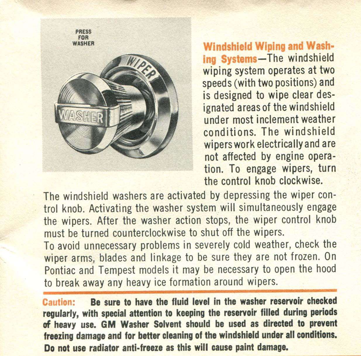

Does the 68 Firebird wiper switch have a off position, and then also 2 speeds, and then also fluid squirt position? And on the squirt fluid is it push in, pull out, or turn all way to right momentary position? Thank you. Jerry

From the '68 Owner's Manual
