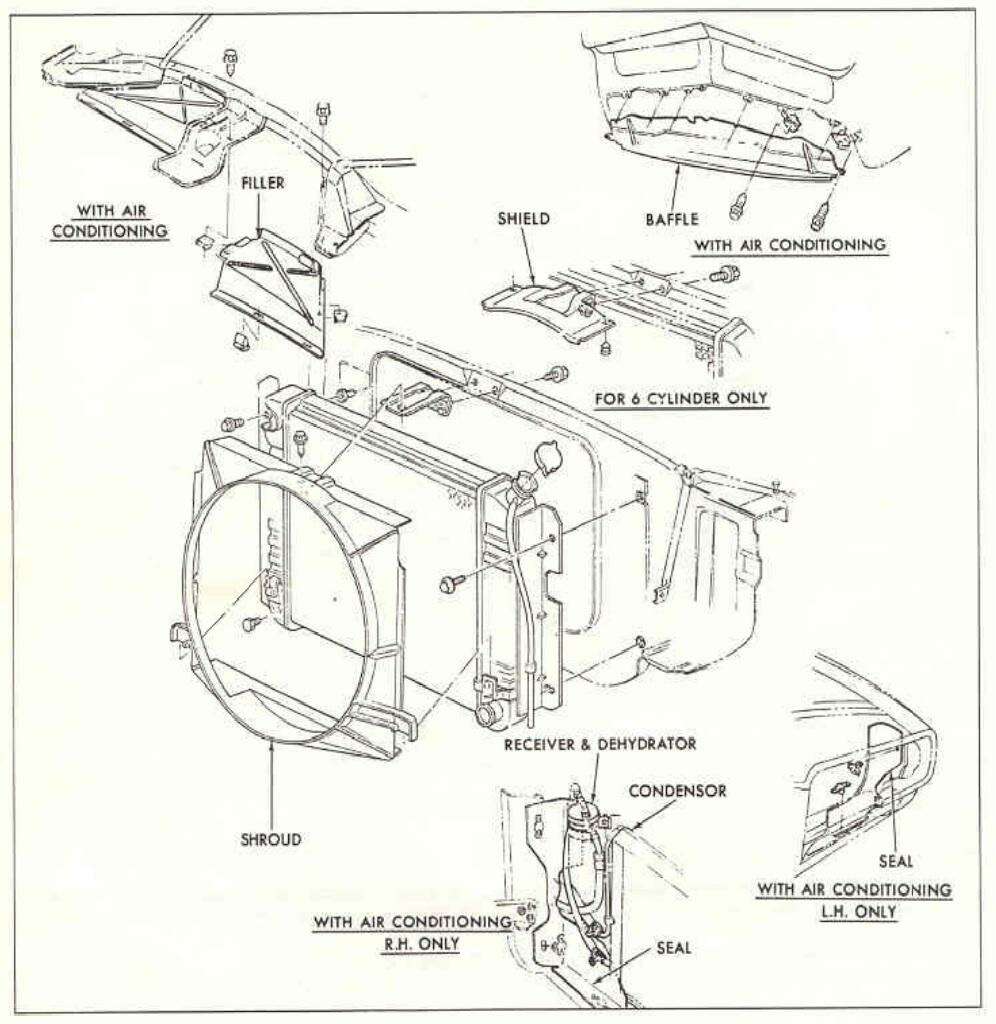

Do you have all the three baffles and two seals that direct air flow into the radiator?

Thanks. I have all of the baffles. What seals are you referring to? Where did you find a 4 core radiator? I wouldn't have rec-cored the one I have but the guy who rebuilt the engine had that done and told me about it afterward.
If you have all the baffles, you have the most important of the parts that direct the air flow. The seals are a rubber-like (they have also been called masticated fillers) seals that are on on the right and left side in front of the radiator. See the bottom two illustrations on the attached diagram from the 1968 Service Manual for where the seals are on the '68. I am not sure if '69 is the same.
The rubber seals are the same (or at least very similar) on a ´69 too.
