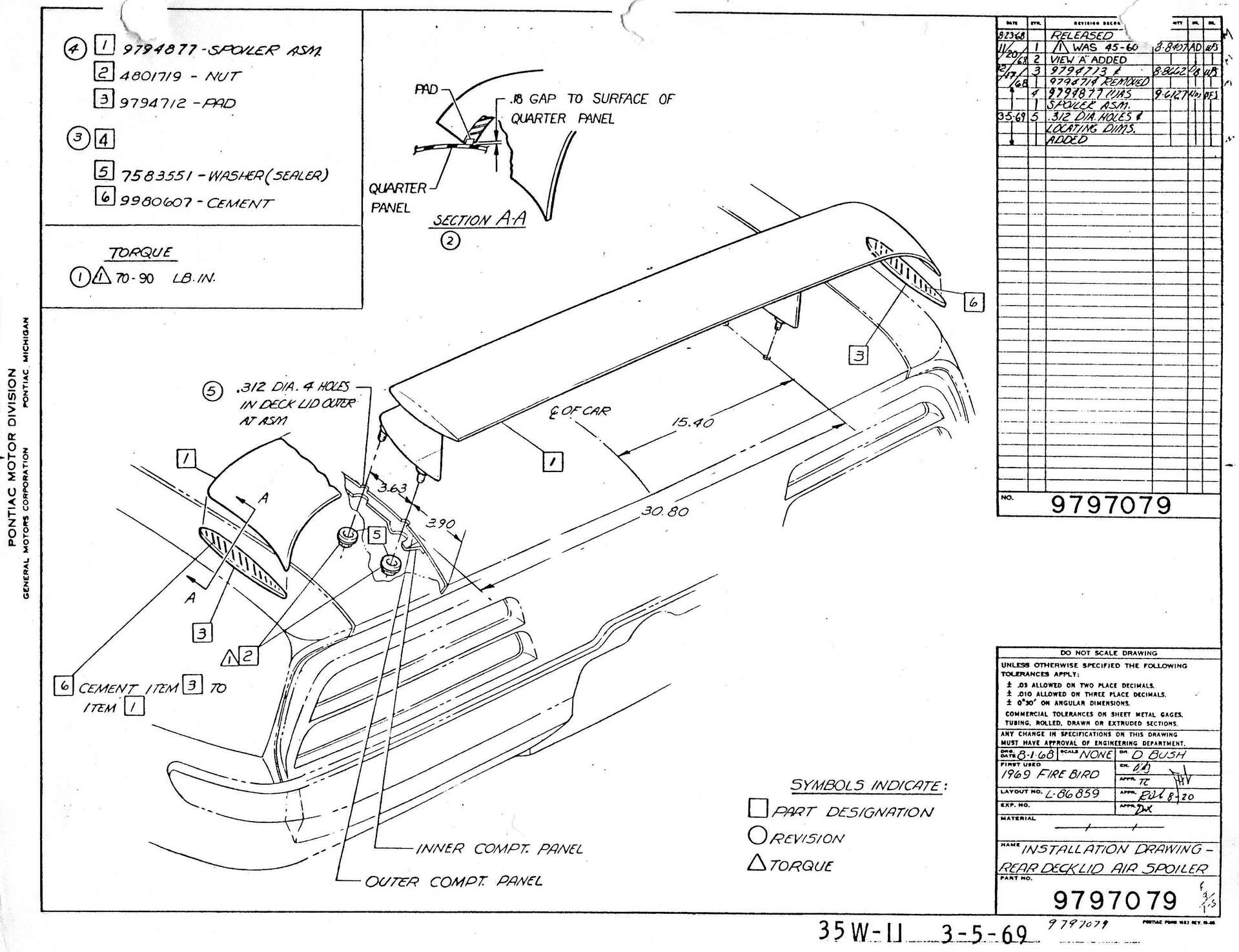

Is there a template or diagram as to the correct mounting position for the trans am spoiler for 1969. Just opened the box and am trying to make sure correct as I wanted to install today and there is no mounting diagram ???

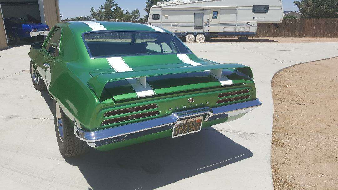

this will get you close, I still had to make little adjustments to fit my car like I wanted it to, Also remember it does not go all the way from body edge to body edge, it looks like it is too short but that is the way they are.
Thanks My wife and I have had it since High School, she got it in 1975 we are the second owners. It was just a plain jane 350 2bbl with a TH-400, and deluxe interior.
That Fantastic to own it that long!!! I bought my first one in 1975 and was my favorite but could not keep it over the years, so now I am reliving my childhood wiht this one!!! I have been saving and waiting a long time to actually get this one going
