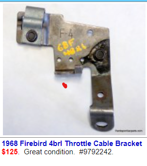

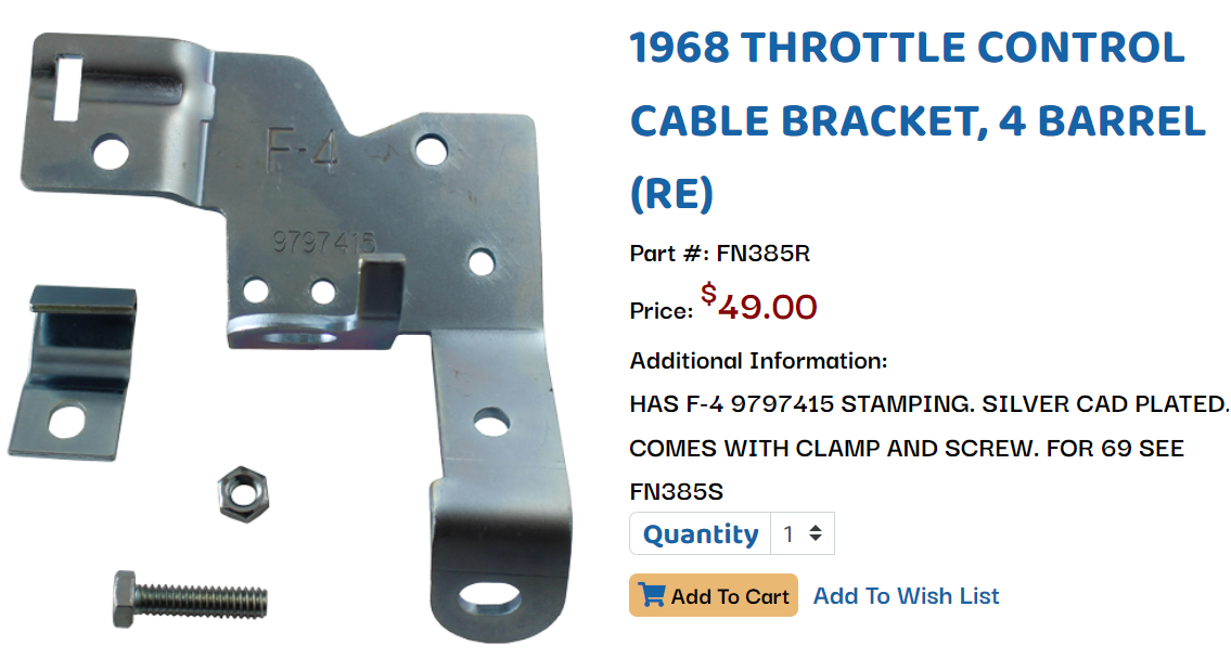

What is the correct bracket for a 1968 4-bbl powerglide: F4 9797415, 9792242, or something else?
PN: F2 9795715 should be a 2 bbl.
From an old posts: In '68 there were two 4bbl throttle brackets used. When GM changed the intake manifold mid-year (May) they also started using another bracket
The throttle bracket is the same for 350-4bbl/TH350 and 400-4bbl/TH400 Firebirds. The TH350 used a cable kickdown, the TH400 used an electrical switch shown in my photo, which mounts to a separate, curved bracket. The kickdown cable used the square hole in the throttle bracket for an attachment point.
Also, does anyone has a pic of the powerglide kickdown bracket on the intake?
