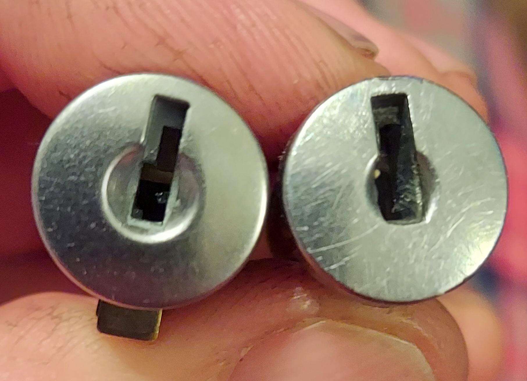

Hi,
Can you please share the correct GM part # for the 1967 glove box door lock cylinder. I bought one but its not correct. Key does not fit.
Thanks

It seems like it should be 7645835, based on this page: https://www.teufert.net/partbook/67-76/10-p.pdf
Look under "10.266 Cylinder, instrument panel compartment lock".
