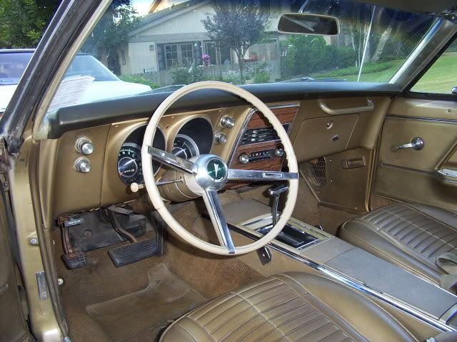

I am painting the car the original Coronado Gold, but the new paint is with a clear 2.coat.My question to you guy's are: Was the whole car and dasj painted in the same color code.Did they use the same color code on the center consol and door trim to? (the old paint is faded)

Bjorn K, My 67 was originaly Coronado gold with gold interior (257)the colors are not the same. Your interior looks to be in good shape and the fading and turning greenish is the same as mine was. You can get spray dyes to touch up the door panels and vinyl.Maybe buff the paint. PS, Mine is now all black.
John is on track here. Upper panels were about a 60% gloss in the same color typically, the dash face I beleive was a 30% gloss and usually a similar color but a shade darker (Mine is a darker Blue than the Tyrol Blue) and the dash top was a 0% gloss to match the dash face color. In your case it looks to be the same color the upper door panels, a shade darker on the dash face and dash top and in the different gloss levels.

Hi and thank's everybody. When I look at "1967 Firebird Paint color Numbers" that Jim posted, it seems to be tree color's. Exterior: Coronado Gold (O) Interior:60% Gloss Signet Gold Upper Instrument Panel:0%Gloss Midnight Champange Did I get it right?
