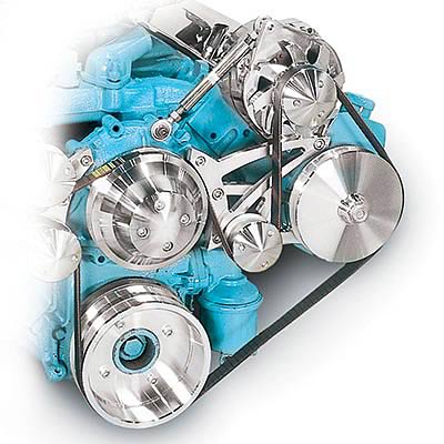

Thanks guys, I just ordered the 10si 100 amp chrome alternator, and the March serpentine pulley kit with chrome power steering pump that looks like this:
I'll take a pic when they come and I get them installed.
