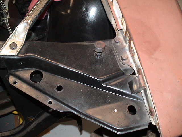

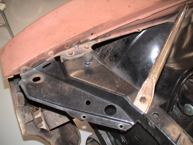

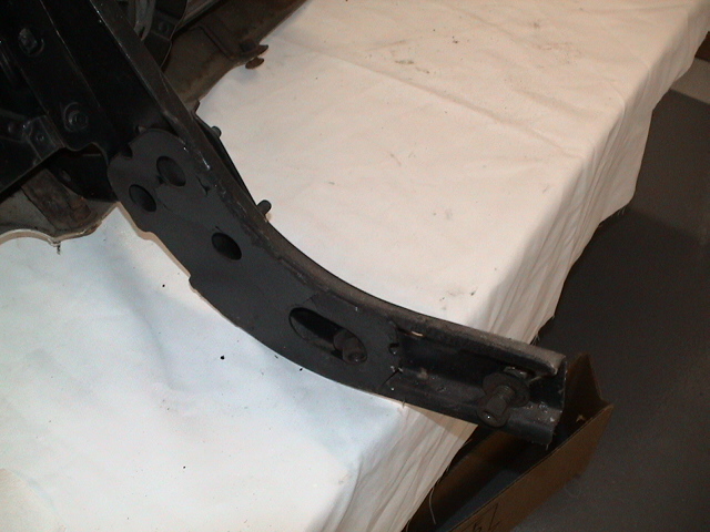

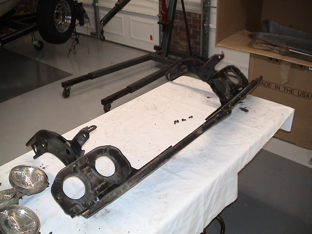

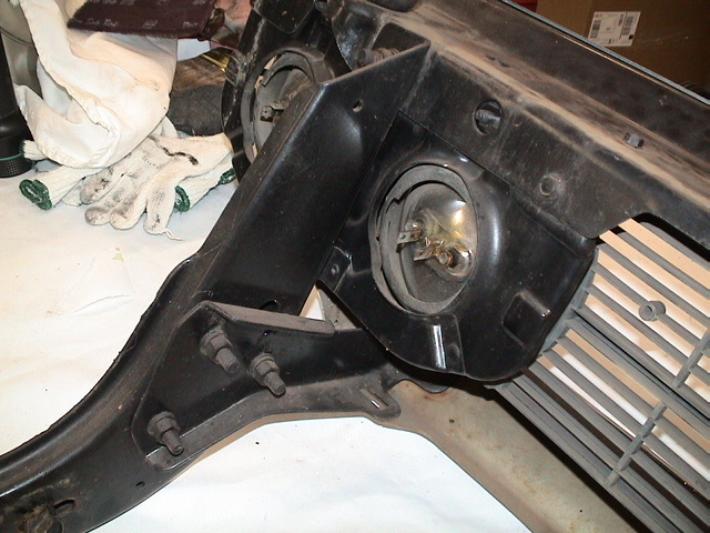

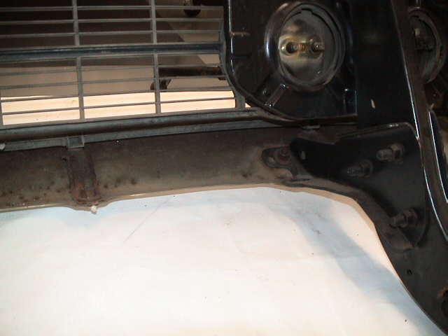

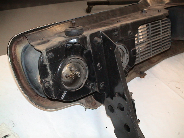

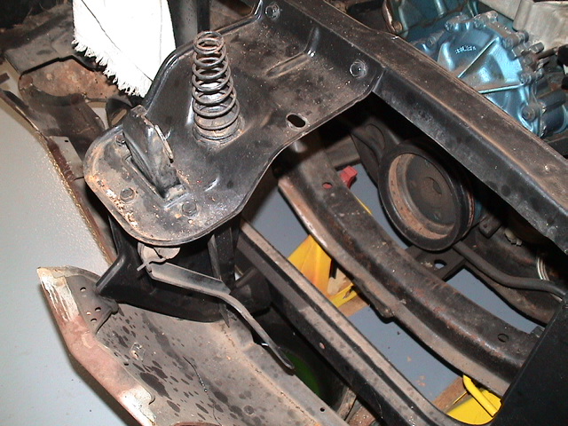

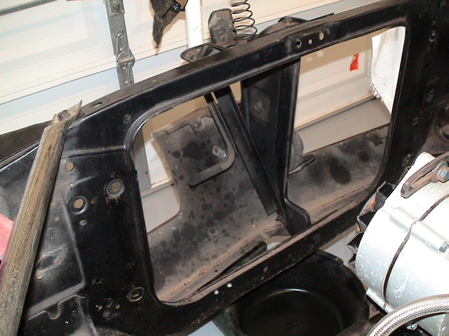

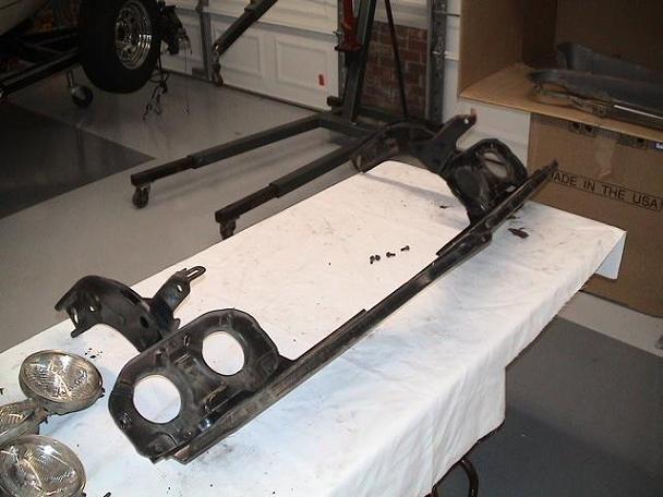

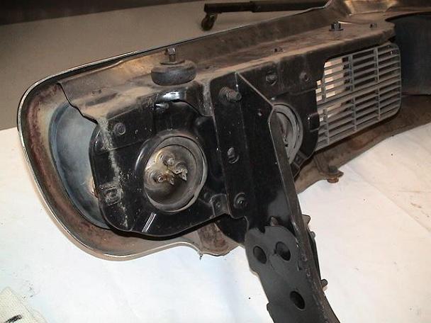

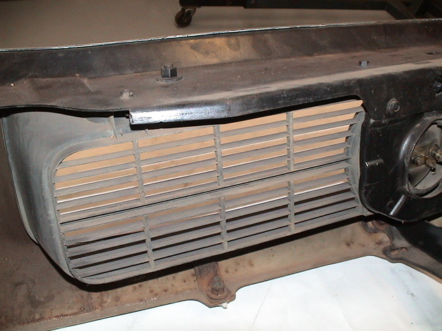

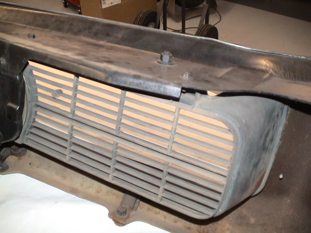

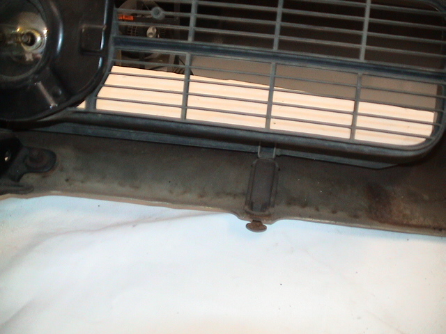

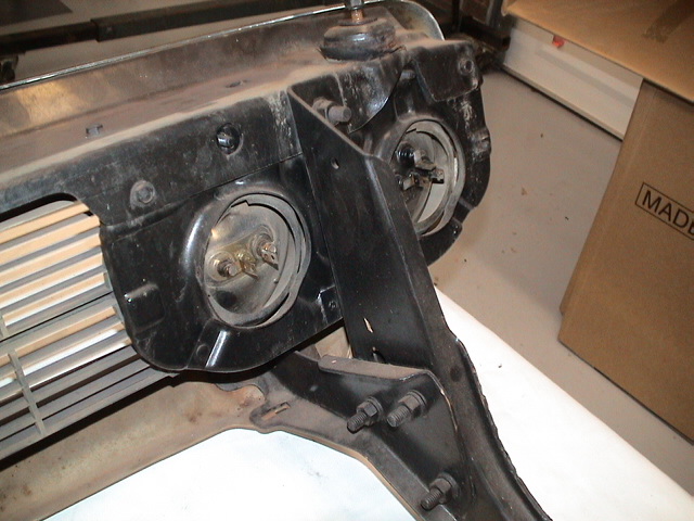

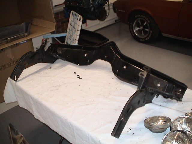

Does anyone happen to have a 67/68 Firebird with the grill out of it? I need a photo so I can assemble all the bumper, fender and headlight brackets and over lapping parts up in front of the core support?.. I can't quite see where everything goes.. I'm having a tuff time with these limited assembly manuals. I can post a pic of what I'm doing if it would help. Thanks for any help or advice.
Welcome to FGF. I have the front assembly off of my car.Everything is pretty much off of it except the lower valance,hood latch assembly and upper panel (which the latch goes through.If a picture of this would be of help let me know and i'll take some pictures for you tonight or in the morning.

Man, you guys are a new and improved kinda' cool!!!... That was by far the fastest and most super awesome reply to a call for help I have ever even heard of!!..lol.. Makes a guy feel welcome, thanks... That is exactly what I needed ho428, thanks man!.. You guys take a look at my Fbird at the link below. I'm sorry I had to put a BBC in it, I hope you guys don't throw me out. I'm saving for a 455 or 428. I'll be making good progress now... Thanks you guys!... www.baitpump.com/gurch
Can´t remember where I "stole" them, hope I don´t offend anyone who´s recognizing his own site. My sincerest apologies - the pics have been very helpful!
BTW - for installing the front bumper including the grill with lights I had to remove the valance panel and the lower panel filler again...
