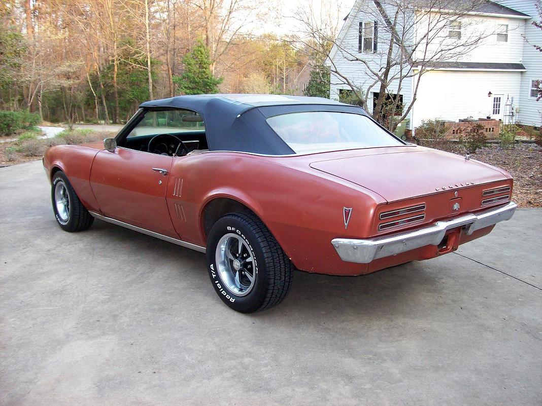

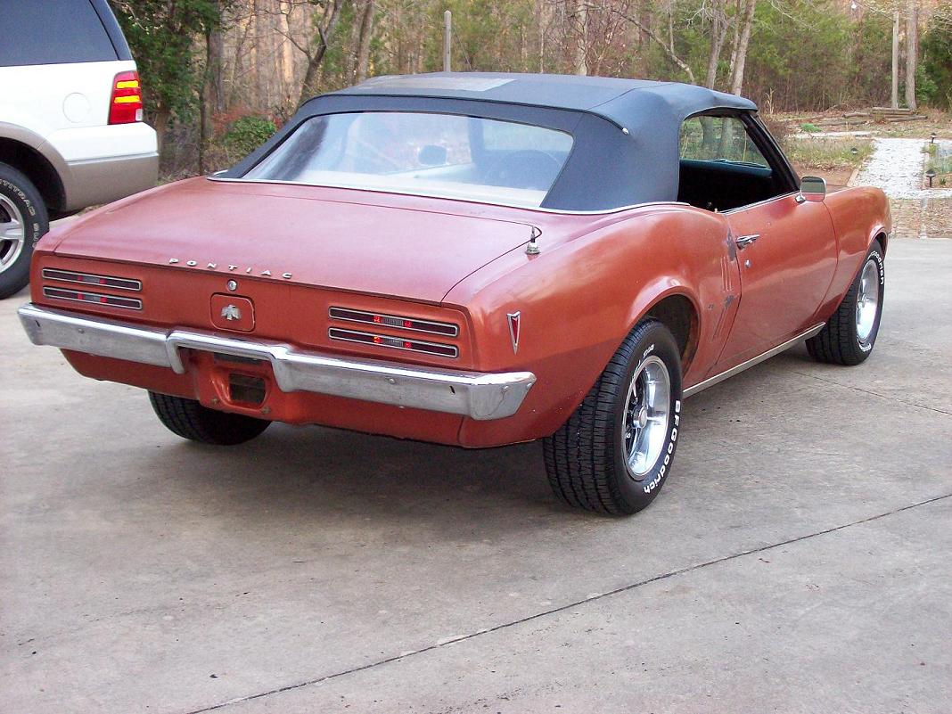

It's been sitting for about 15 years. A flat right front from time to time I'd pump up but it'd leak down again. So it sat cockeyed sometimes for weeks or months.
New tires, same size all around, but now it sits uneven, mostly visable in the rear. Leans to the right with to much tire clearence on the drivers side. Didn't sit that way when I parked it. Almost like the right side springs are shot.
So I put jack stands under the front frame and two more on the rear frame at the rear spring perches to let the suspension hang free to see if maybe it was just the shocks binding.
Well the left rear frame rail never touched the jack stand, about an inch off. It was sitting on three points. Nice to know the car is that stiff but...
No damage I can find, body bushing seem fine, no structual rust. Only thing I see wrong is the X-brace is missing.
Any suggestions?

When you sit in it, it would be level...
Air shocks in rear?
Probably just stiff after winter..take her for a ride.
Measure the distance from the top of the tire to the fenderlip. You will have to eyeball. What is the difference? Count leafs on springs as well..some are 4 some 5 and some have different rates. Springs should and need to be changed at same time. If I changed one broken 35 year old spring with a new one and installed it, what do you think would happen stance wise over time if I had a new and old spring on the rear?

Mine sits about 1" low on the driver side. I have been COMPLETELY through the car and don't know why it sits like that. - New shocks, springs, subframe bushings, sheet metal has been R&R 'ed, core support, you name it.
I have grown to accept her as she is ... saggy on one side.

Typical of old leafs.

Mine, is sitting low on left. New springs too, Air shocks with seperate fills net step.

When a front coil spring goes bad it has the effect of the opposite rear corner lifting. My cammer sat with a lean until I changed the front coils.

I have a front spring thats bad and my right rear sits low. I put the front of the car on jackstands and she sits level

So left rear high,right front soft?
