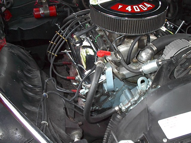

I have the same problem....could not find an "inline shutoof", so I made one... got a couple of brass fittings from home depot, one with a shut off lever, cut the rubber hose to the heater box along the valve cover in a spot easily accessed , installed my shut off there...brass fitting a little heavy so I also installed a bracket that holds it away fro the valve cover, paint it engine color, and now I can totally shut off the heat...open the hood , open /close it..usually once or twice a year...summer /winter
I know ,its "rigging" it , but works well....dont have a pic available...but can take if wanted...
I`ll be with my car in an hour or so, I`ll take one , just incase...

heres pic of my 'solution'

Good idea Bjorn. I was pointing out that it's a 'nearly factory' item. It's just a little up stream from where you put yours. I have mine so it's shut off all the time the engine is running because I hooked straight vacuum to it. If it gets cold I use the other vacuum line from the AC. That way I can keep it closed without having my air conditioning running.
ahh ,another good idea...maybe weighs less too....

That looks like a 1/2" gas valve Bjorn.
Does it have AGA stamped on the side ?
AGA, a Swedish gas parts (and stoves)manufacturer , nope...it doesnt... just a common Home Depot cheapie...cant remember if its 1/2" now , but I suspect its 5/8"?
AGA, a Swedish gas parts (and stoves)manufacturer on Lidingö outside Sthlm, nope...it doesnt... just a common Home Depot cheapie...cant remember if its 1/2" now , but I suspect its 5/8"?
