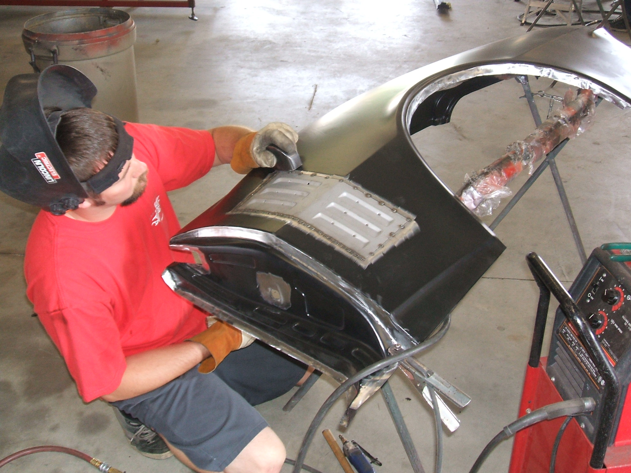

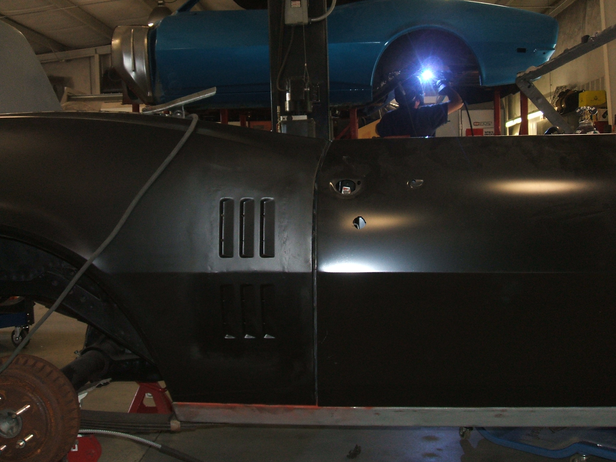

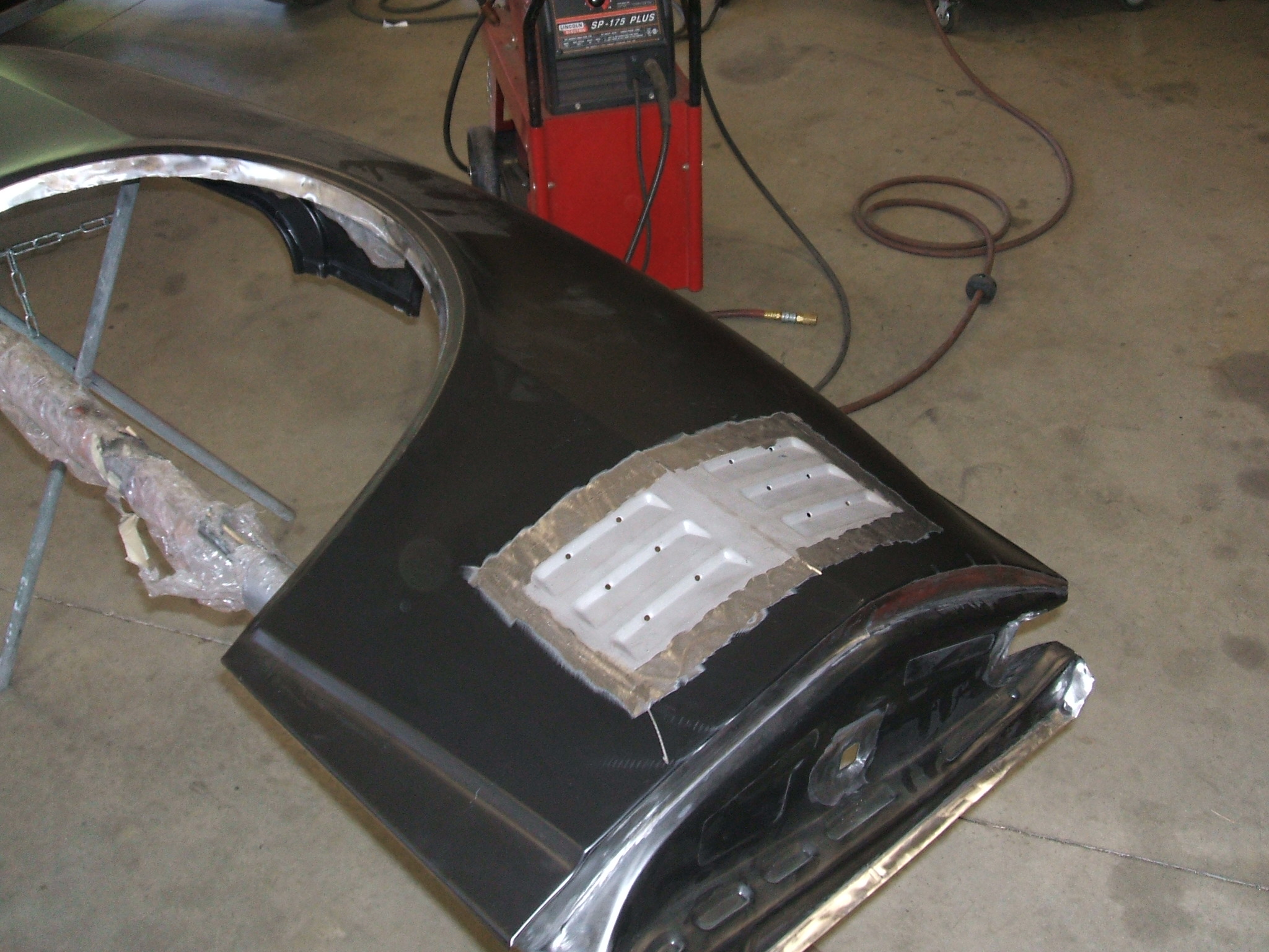

Good to have atleast the outerwheel house, trunk drop of panel( attaches to bottom of quaarter behind rear wheel. I've not had a chance to compare panels from the various suppliers but I would bet they all come from the same Ti wan stamping plant with Chan stamping em out.. I've not seen any full convt panels as of yet, Classic keeps saying they are comming but I've heard they will not ever be released because the repaired tooling was crap and the cost to create new tooling is big $$. I did hear Heartbeat city was supposed to be releasing a 67-68 convt panel soon but the cost was going to be very high. I just had mine replaced on my 68 convt and had to use Camaro quarters with the louvers sectioned in. I'll be adding pics of the process to a thread I Started in the bodyshop section (Georgia) in a day or so when I get my cd that contains all my pictures of the process.

I asked the shop to stay away from the louvers as far as they could as well as use the edge of the door jamb to section in but they did it they way they wanted. By using the front edge of the jamb it would have created on less seam for filler. They way it is now there is a tiny bit of metal work that need to be done to make them perfect. Where can I post all 58 pictures of all the work ?

The full quarters were OER and they had their share of problems that required a good bit of extra work. When you see the rest of the pictures you will see the gap problems as well as the right side being too long ! But the pictures will show what we had to do to remedy it. The shop said if they ever did any more of these they would use Heartbeat City quarters (Camaro) or wait for the Firebirds to come out..

Am I happy with the work you ask ? yes I think so. I would have liked to see the louver section a little more finished with the front seam at the jamb like I asked for it to be. I think the work is solid and the finished product will turn out well.

The work looks nice. They took time to fix panels where replacement pieces didn't fit, so your project will look great when you get the final blocking and final paint. They did a nice job. You must be very happy to reach this milestone.
