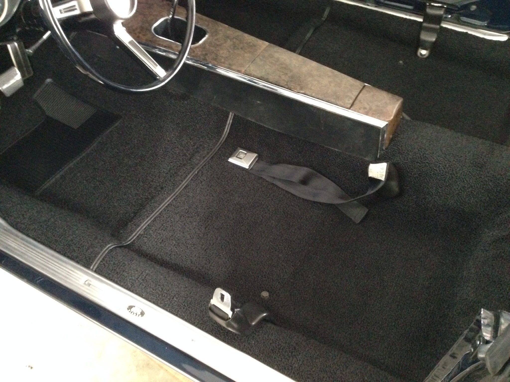

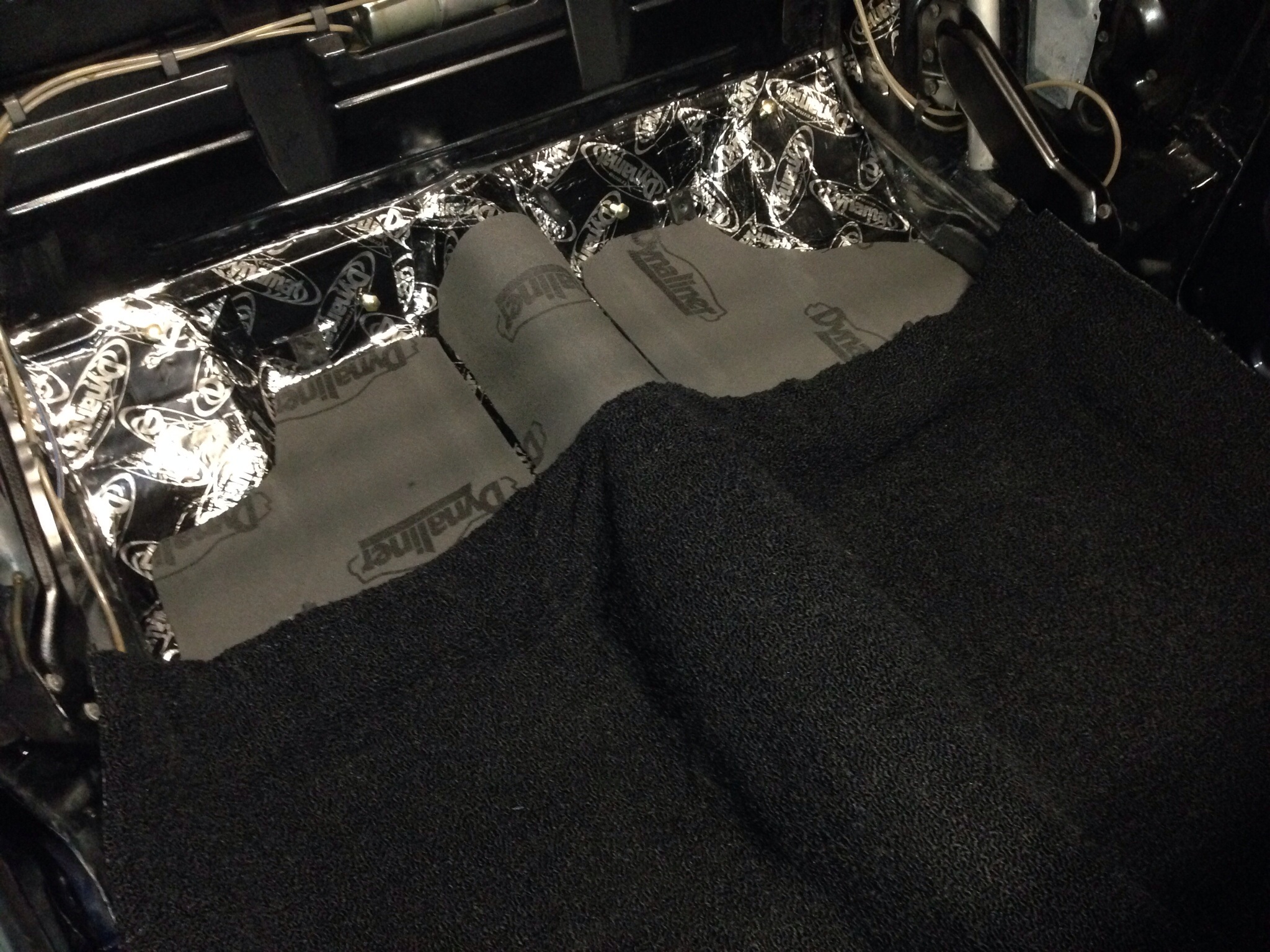

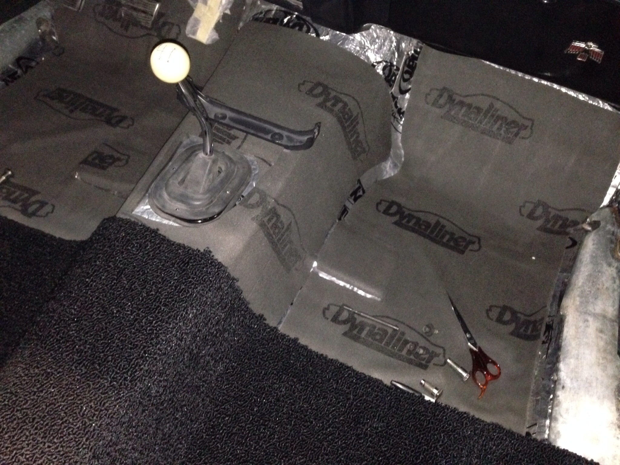

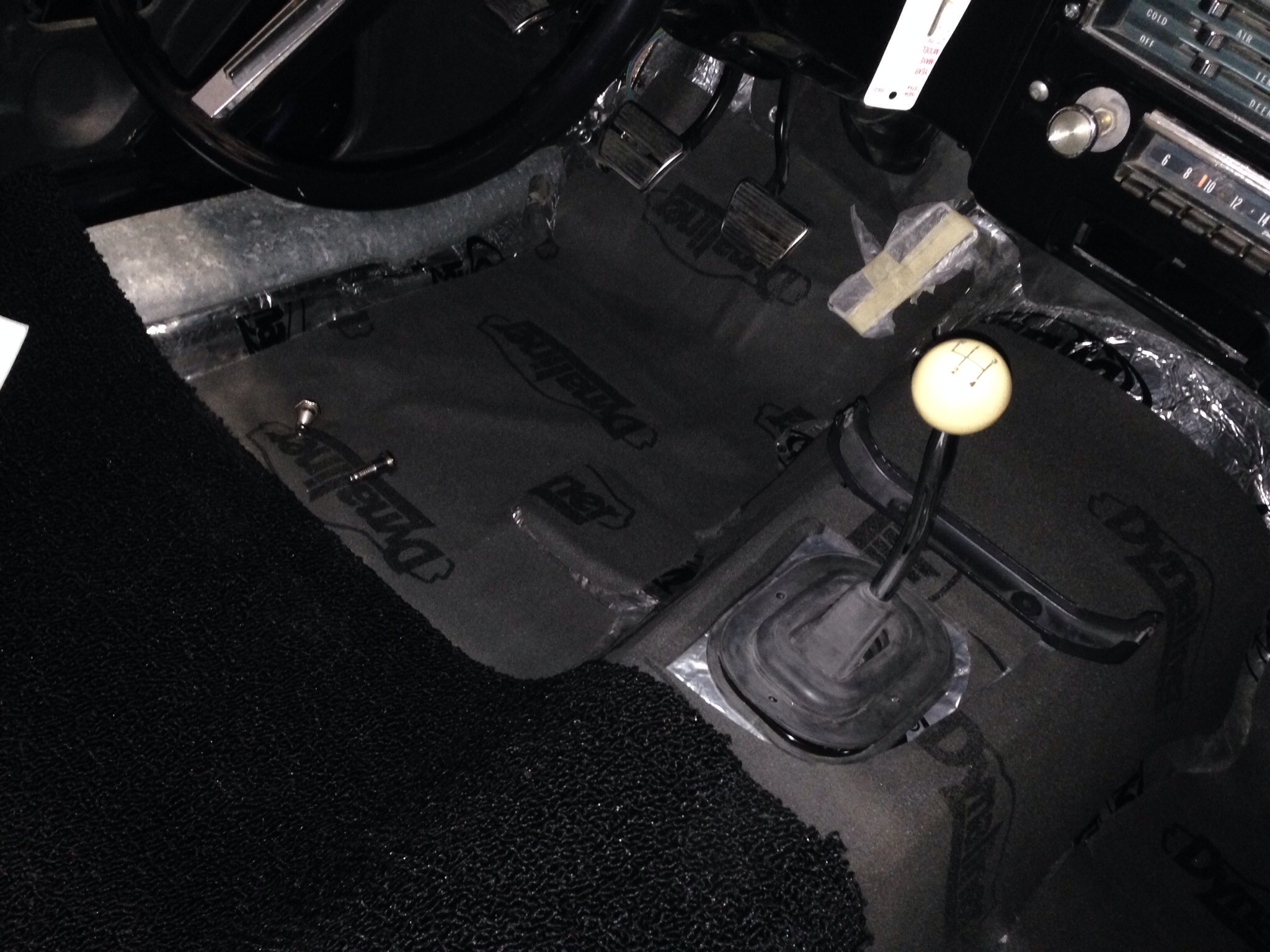

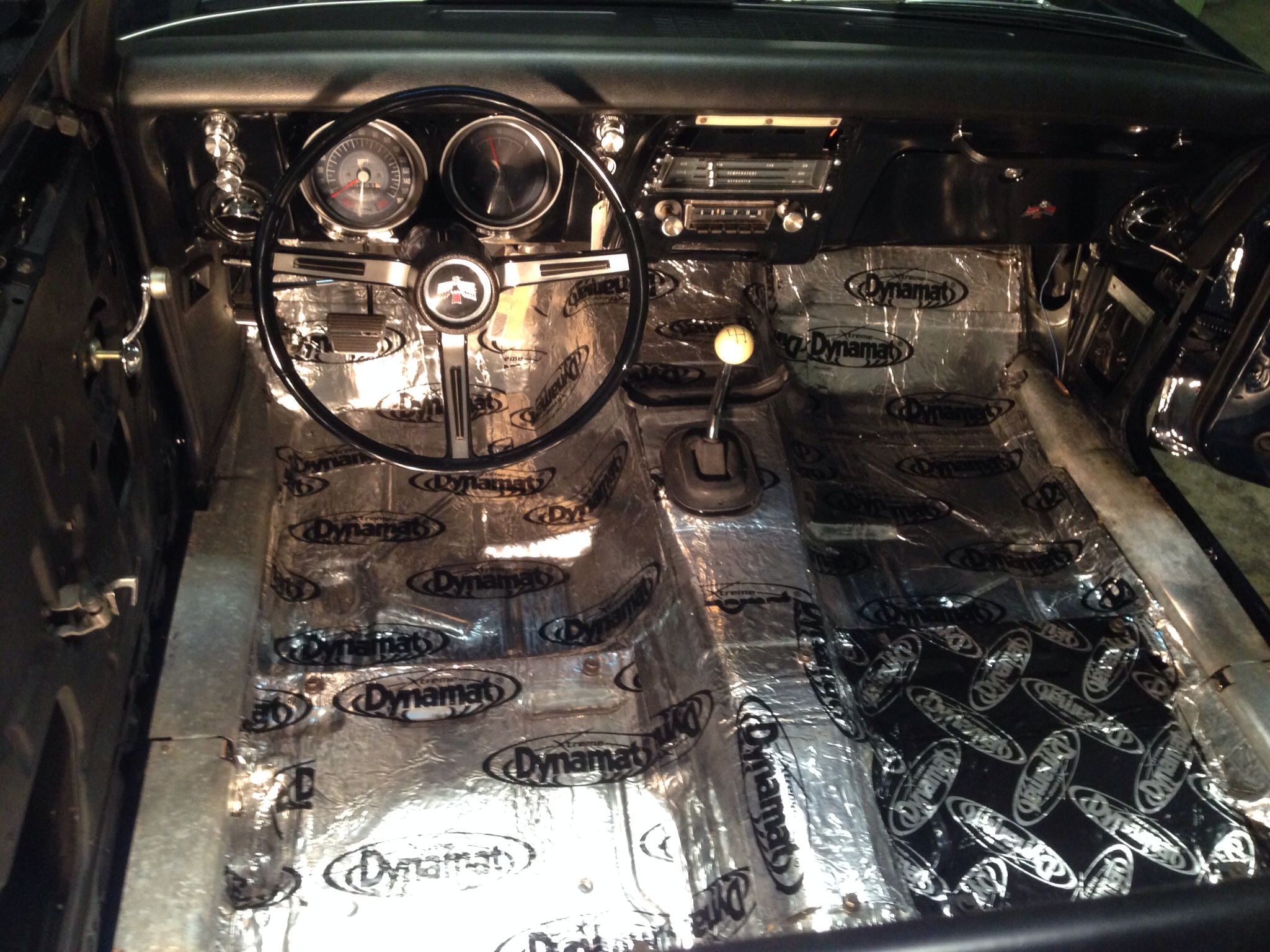

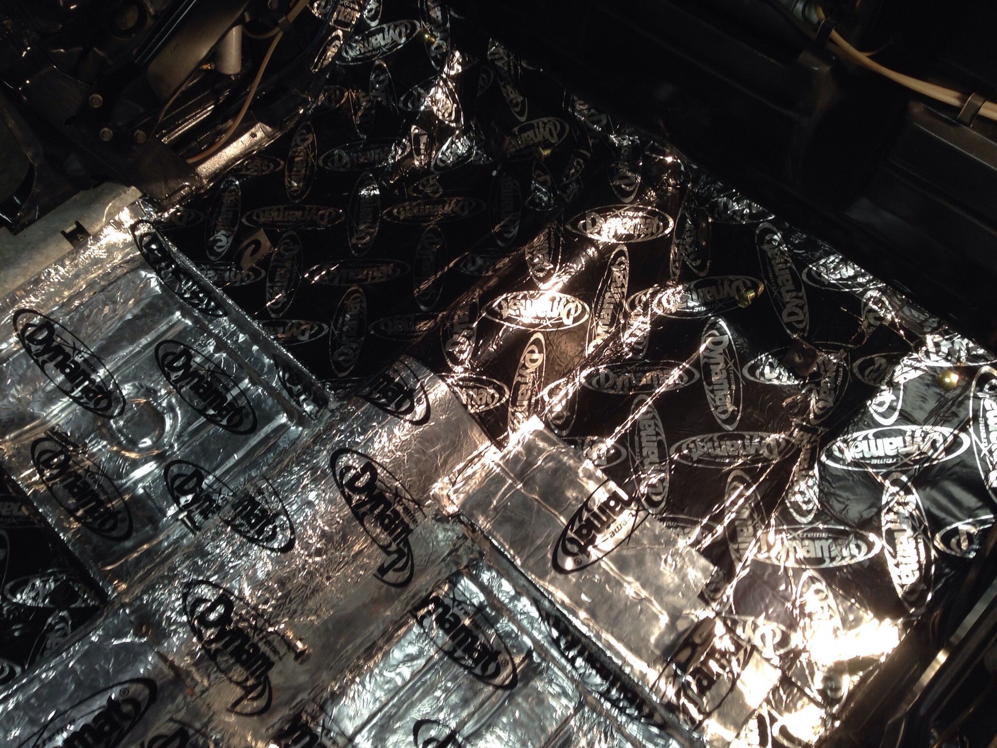

I got the Dynamat Xtreme, 1/4 dynaliner and carpet finished over the weekend. All of this was very time consuming. When I first thought about installing carpet my thoughts were it could not take that long to do it. Boy was I wrong.
The Dynamat Xtreme and the 1/4 dynaliner thickness was no issue under the carpet. Matter of fact it seems my carpet from trim parts was quite big especially over the tran tunnel.

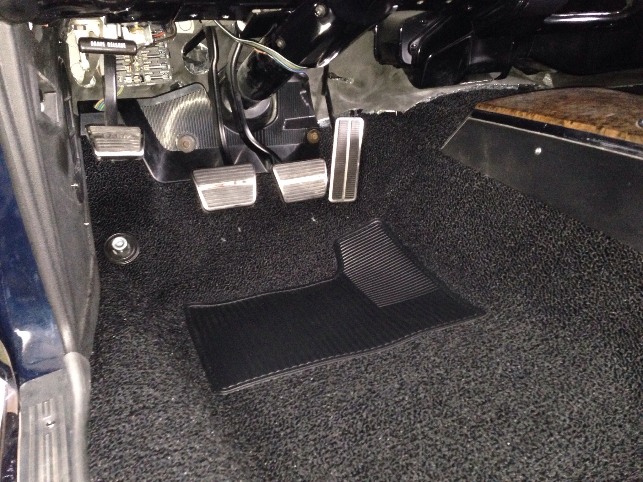

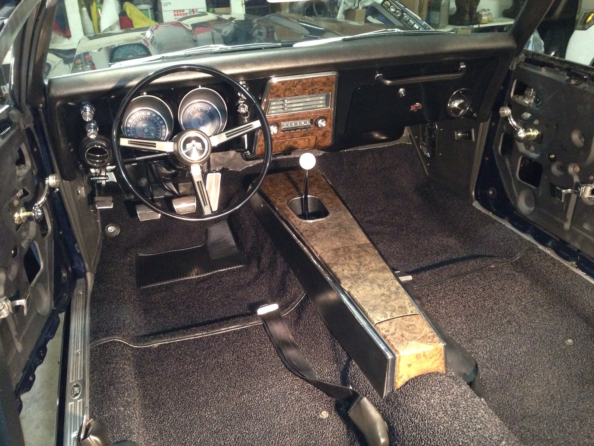

Some photos of the carpet install. The carpet is bulky around the trans tunnel and the passenger side. I hope it relaxes some but the backing attached to the carpet seems to be making it not lay perfect.

Hey Harold, that looks good man! Thanks for sharing the pics. What did you use across the front of the firewall?

I put up dynamat extreme and then used an original repro firewall mat.
