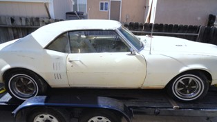

Hey guys. I just bought a very rough 1968 Firebird coupe from original owner. It's been sitting in a barn since 1981. Only (significant) rust is in floors and a little in the rear window channel. All the interior/exterior colors and accessories match the fisher tag...but It also has a "yw" motor with original 7028264 xe carb. Could it be a real HO car??? No aftermarket parts anywhere. What do you think?

The YW is the '68 400HO automatic engine code. Look to see if the VIN on the front of the engine matches the vehicle VIN.

Is it next the "yw" or in another spot? I thought they didn't match engines to the cars in '68.

The VIN is on the engine in '68. It is difficult to see. You can find it on the milled surface under the radiator hose connection to the engine. This shows the location: http://www.teufert.net/identify/identify.htm

I just checked the 6 digits to the left of the waterpump housing and they match the last 6 on the vin. Thanks so much, you made my day.

Now you may want to order the PHS (Pontiac Historical Services) documentation to see the complete record of the build for your car.
With the YW, you have 1 of 684 made.

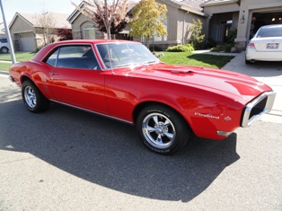

That sounds like a great find. Please post some pictures when you can. Finding one of these cars with the original engine is a big plus.
Jim has a very nice car and is a good source for Firebird information.
[Linked Image from img120.imageshack.us]
[Linked Image from img179.imageshack.us]

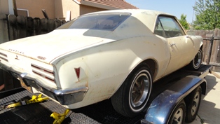

I also have a '68 350 car. May sell it to finance the HO rebuild.
