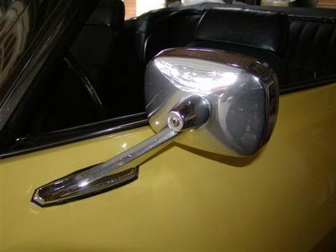

Vikki shared some pics of her 69 mirror with me a while back so that I could compare to what I had bought off Ebay. Turns out I wanted a 68 mirror but ended up buying what turned out being a 69 GTO mirror.
I was young. smile
The 69 FB and GTO mirror are the same in all respects except the shape of the control knob, bezel and cable length.
With Vikki's permission, I could share her pics so to compare to the pics of the 69 GTO mirror I have.
By the way, there are some mirror parts on Ebay right now that are for a 69 GTO. The oval bezel in the middle is correct for the GTO. This isn't a Firebird mirror - the knob, bezel and cable are wrong.

By all means, feel free to share any of my pics for informational purposes.
I have an original '69 rectangular mirror on my '69, and an original '68 round (early) remote mirror on the '68. I can get fresh pics if needed.

That's a late 68 mirror, according to the part number on the box. The 69 FIrebird remote looks like this (pics courtesy of Vikki):
Here's a pic of the 69 GTO mirror I have. Notice the top of the base where the screw is looks slightly different. As well, the control knob is a different shape (the GTO knob is more cone-shaped) and the bezel (mine is like this) is elliptical like the one pictured in the last pic.

The rectangle bezel (to the right) in the last pic is for the remote mirror/standard interior.
