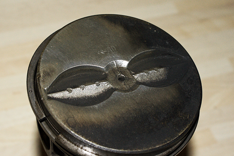

My pistons look like this:
With 'O' on the rings and '<<40' on the piston. Does this mean my pistons are oversized by 40 thou (and hence my cylinders bored out)? The rings would be standard ('O') to these new pistons, not the originals?

"O" on the rings means "This side up" and the "40" probably does mean .040 over. Do you have a shop that can measure them?

yes, the engine is 40 over bore. i would try napa auto parts. if there are a lot of miles on it i would definately have the block checked. you only have 20 left to bore out if you need to.
The standard bore size for the 326 is 3.718. The standard bore size for a Chev 305 is 3.736. If your bore is .040 over for your 326, you need .020 over Chev 305 rings. Lots of suppliers of Chev 305 rings out there.
