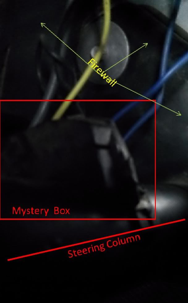

Something I found that may be my issue but makes me nervous: On the steering column, just above the break pedal there is an electric component box. It looks OEM, says Delco on it... has many nubs for wire fittings, but nothing is attached. There is a black wire that has some electrical tape hanging near by... I want to connect it, but again... nervous lol. Anyone know what that box is for? should it have wires attached to it? Is it OEM? should I post a picture, or do you guys know what I am talking about?

So, I figured a picture would help on any level... so this is what I am looking at, best picture I could take... hope it helps.
The "Mystery Box" is the object in question.
