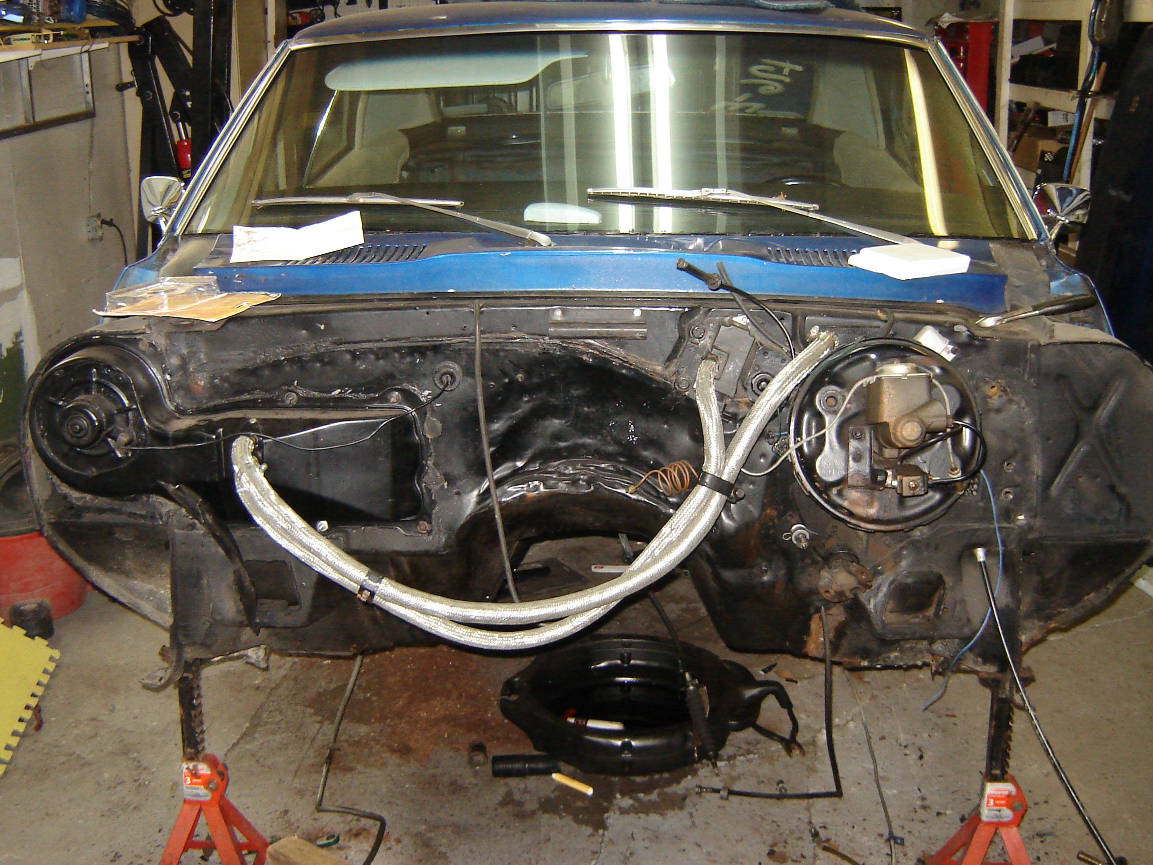

Hi, i was plannng on changing the floor and the rocker panel (that the reason for the new post). Took the car apart, subframe and the rest. The project will change because the toe panel and the subframe mount are rotted. These part with delivery cost near the price of a complete firewall. I'm wondering how big of a job is to replace the firewall and what need to be remove to do the job.

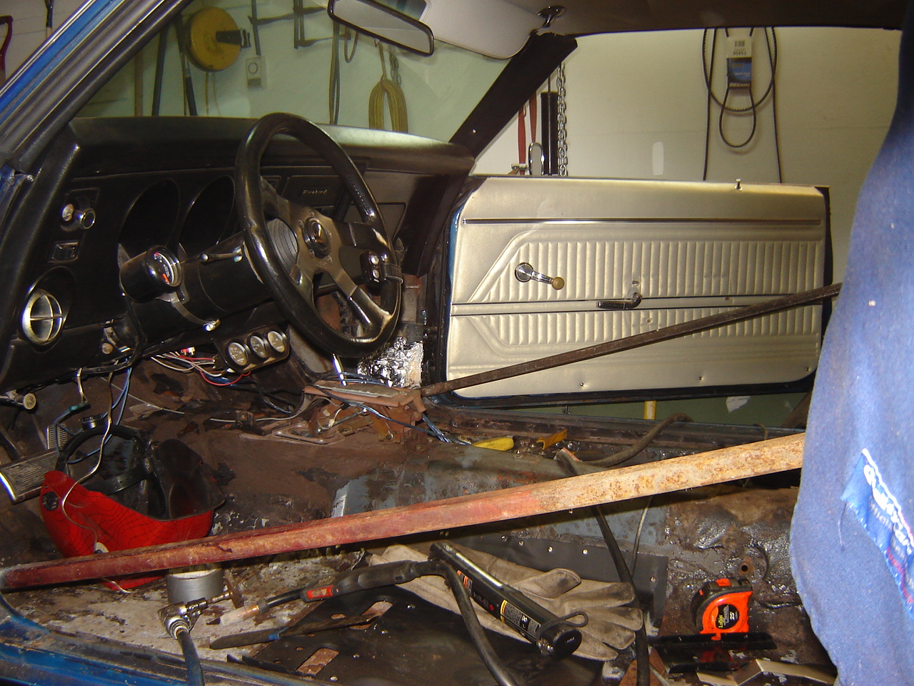

Structurally you need to brace the car very well especially if you start repair/replacing "A" & "B" pillar sections There will be nothing holding the rest in place.

Firewall on the way. I will brace the car from the interior. No money for a jig. The car is a streeter not a show car. The project for now will be the firewall and the full floor. Will see what goes on for next year after the summer. How many brace should i put inside the car before removing firewall

Coupe or vert? If A vert, I braced across the doors front to back, and side to side for the body. Since I also have a full quarter off the car, I also ran a brace down to the B pillar to strengthen and attached it to the square on the side the quarter is removed. Excuse the ugly welds. Coupe may not need as much. More is better where possible.

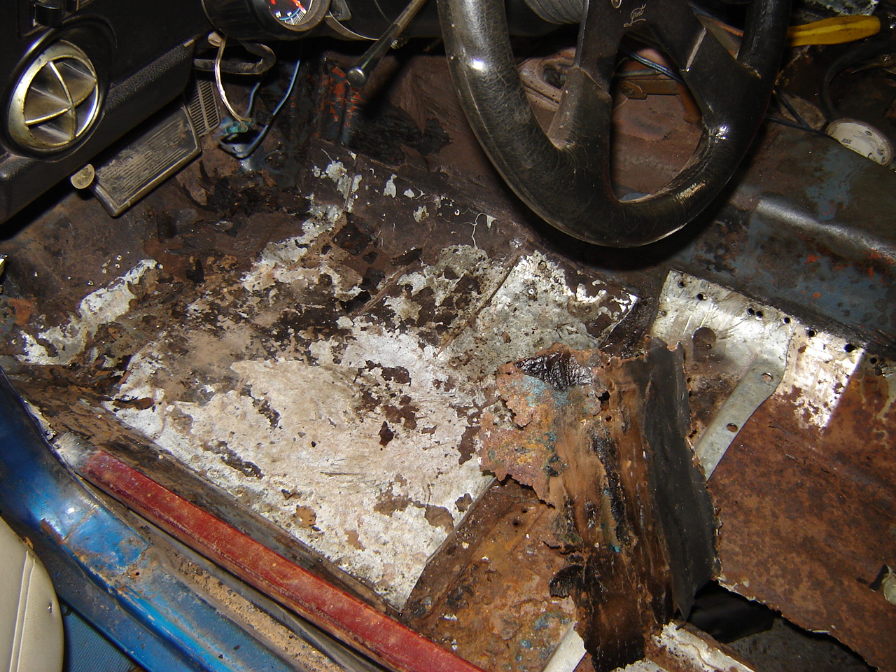

I will echo 4dabird's comment. "Take out as little as possible." My opinion is that you should NOT change out the entire firewall. That's great you bought one...you needed it, and you can now cut it apart and use it for patches. It is FAR easier to install patches than it is to do an entire firewall. None of your dimensions will move, bracing can be less complicated, and your repair will be just as good as a full replacement, and you'll maintain much of the original sheetmetal.
Based on your photo, it appears that 80%+ of your firewall is rust-free. For this reason, I see no reason to replace more than the 20% of it that is rotted...which is probably just the lower ends near the subframe mounts.
Just my opinion. When it comes to large structural componant replacment, sometimes less is more...
I feel the same way about the floor. Cut out patches of rotted metal, use smart techniques for butt-welding nice and smooth if you're concoursing it...or just lap weld and seamseal for a driver...and you can leave the rest of the non-rusted original floor in place. Patching is FAR FAR easier to fit than complete panels are...particularly when you're dealing with resto parts that are FAR from perfect...as you'll soon find out.

Nothing to save here. The floor has been patch a lot with rivits and sheet of metal. I can't repair by patch nothing is good on the floor

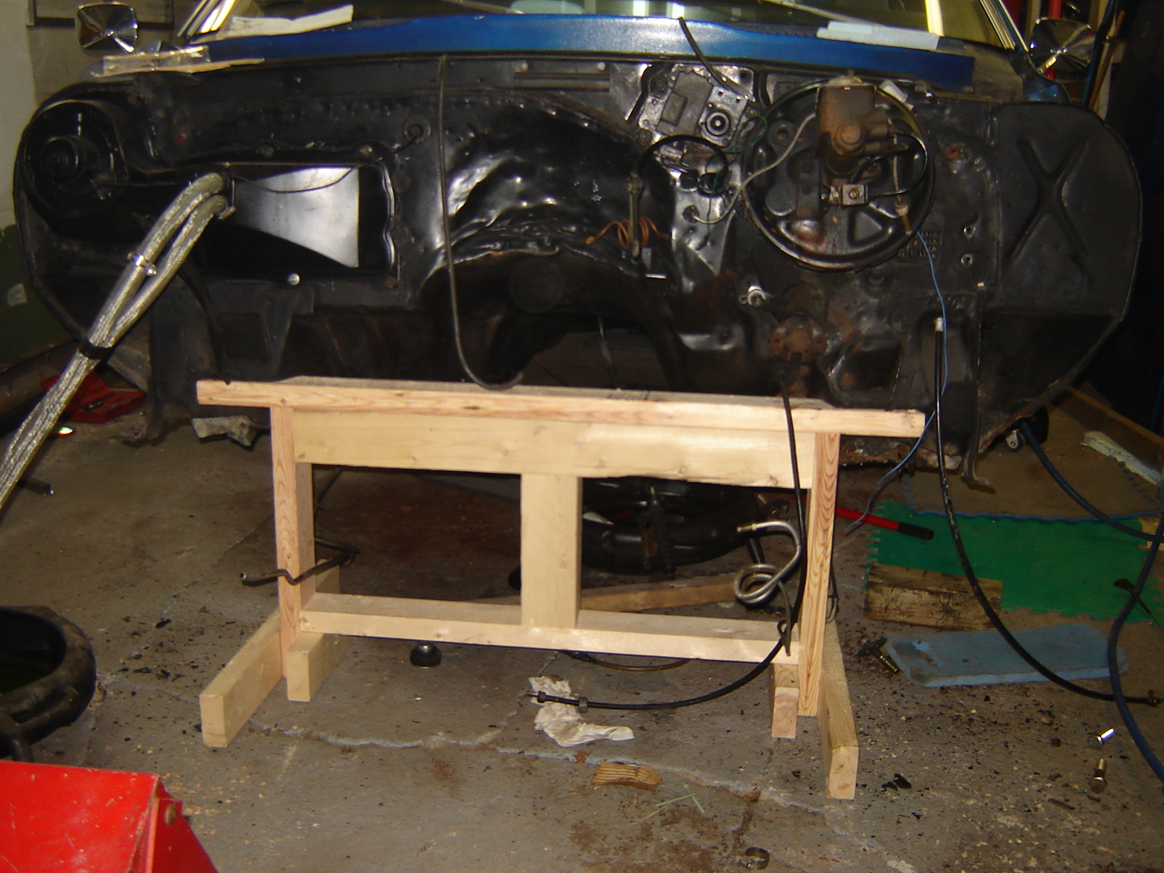

I made my self a small support instead of supporting in the corner I have inserted wood dowels. I know wood is not metal but this i what i can affort for now.
I brace the car in front and in the back of the doors. Is that enough or i should brace from side to side
Any other things should be done before i remove the left over from the floor?
