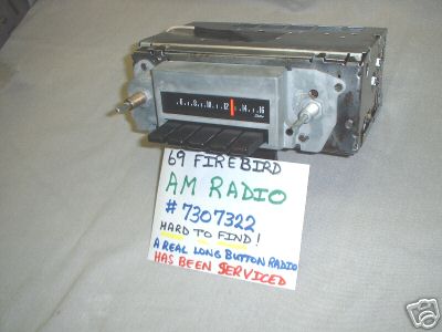

I think i found a 69 am fm stereo for my bird in his stack of radios. it looks right but im not sure.

If it still has the part number sticker on it (from the FAQ):
67 Firebird AM/FM 986824
68 Firebird AM 7305572
68 Firebird AM/FM 7305582
67-68 F AM Die-Cast Face Plate 7298249
67-68 F AM/FM Die-Cast Face Plate 7298474
69 Firebird AM/FM 92FFP1

It's not AM/FM, but does this help? (Someone else's pic.)

This radio looks like that but it has a slide button above the dial indicator to switch am/fm
I have a working AM radio actually 2, i just figured if i can get it for free. i'll swap it out.

i looked on the web, and find all sorts of pix . is the slide bar am/fm selector correct?

I have an original AM/FM (mono) radio in my 69. The band change (am-fm) is done by pushing one of the black buttons that also select pre-set stations. There's no slide bar gto select am/fm. Those are found on 'wonderbar' radios often used in Corvettes etc. The stereo am/fm has chrome buttons versus black plastic, but I believe the band selection is still done by one of those buttons, not a slide bar.
