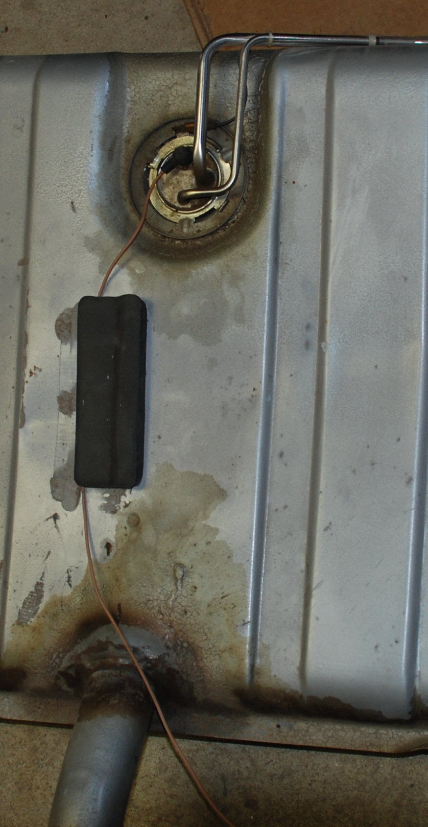

Joined: Aug 2005
Posts: 1,923
Joined: Aug 2005
Posts: 1,923
This is a pic of the sender in my 69. If you save the pic and then zoom in on it, you can see the ground wire at the top right under the fuel lines.
-=>Lee<=-
Joined: Aug 2010
Posts: 232
Joined: Aug 2010
Posts: 232
Since you'll never see it, a small hose clamp over a wire stripped and wrapped around the fuel line will work fine.
I'm not sure you want to use a live fuel line to ground anything electrical. It just doesn't sound like a good idea to me. I'd run it out and use a self tapper into the side of the frame rail.
