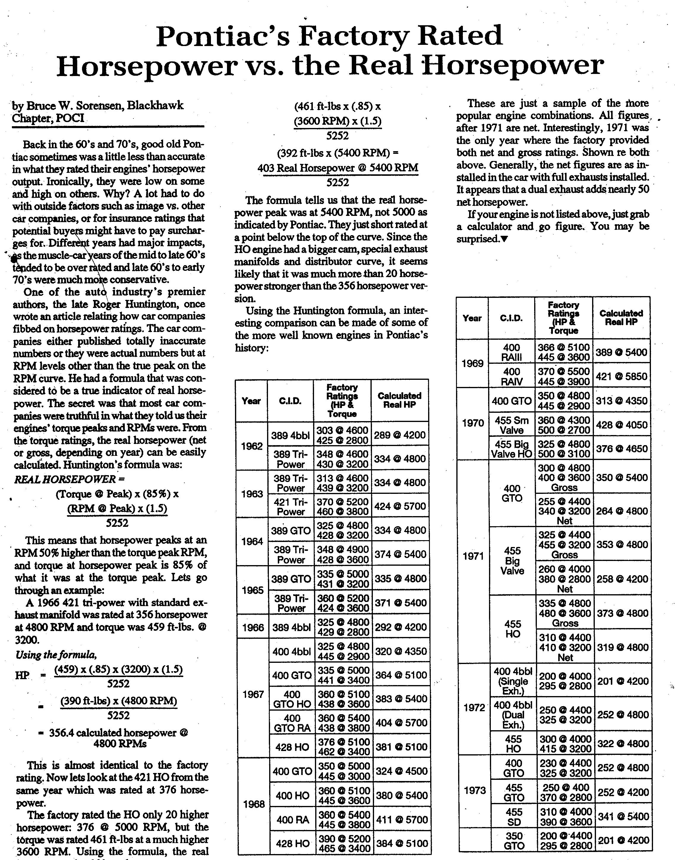

Joined: Jul 2002
Posts: 856
Joined: Jul 2002
Posts: 856
Hear is factory hp
