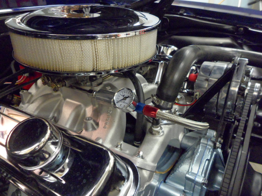

Good Idea, crank it while you're looking at one of these.
Al

Should get 5-1/2 to 6-1/2 with the starter.
Al
