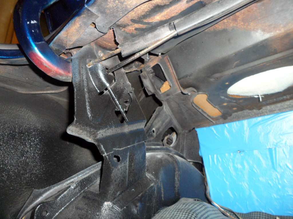

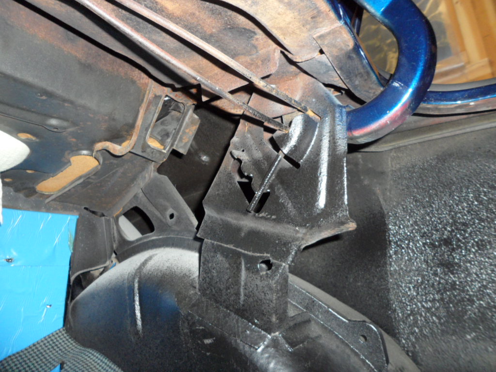

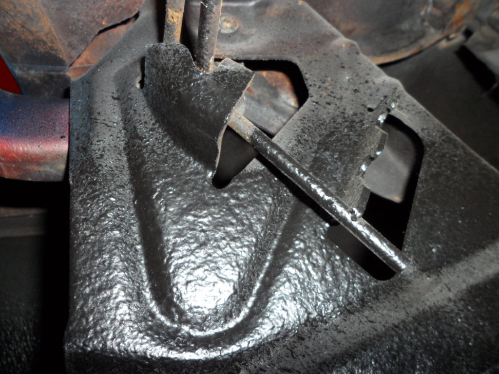

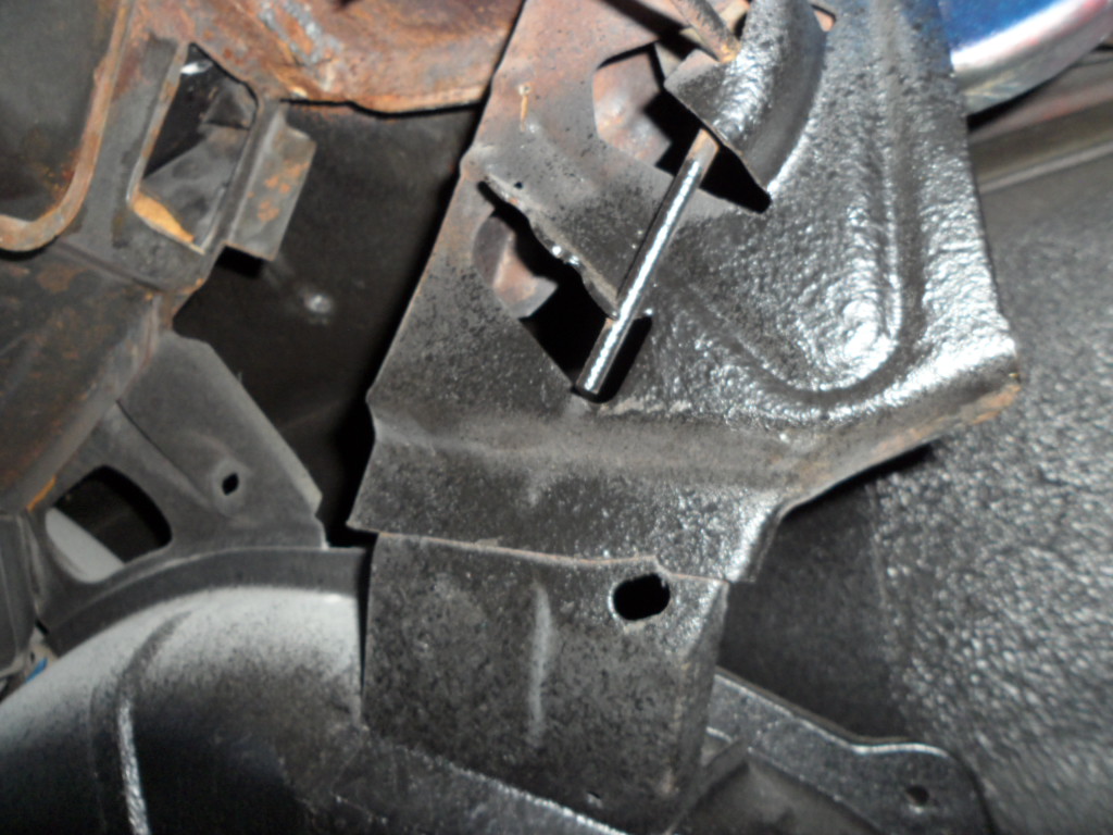

Can someone post a pic of an installed trunk lid torsion bar. Thanks

I set mine on the last notch due to the extra weight of the deck spoiler. They make thicker ones for the spoilers but this just works unless I'm parked on a steep hill or in a wind.
torsion bar 014.jpg torsion bar 015.jpg torsion bar 008.jpg torsion bar 011.jpg torsion bar 006.jpg

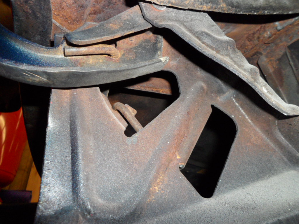

Hinge side
