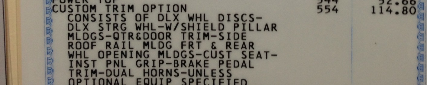

In your phs package, the page that shows addition no-extra cost equipment shows most of the trim options.
It does not show the trim differences between standard interior vs deluxe interior. The deluxe interior option got you the wheel moldings.

OK so what are the other things that came standard on the deluxe interior cars. The car had been repainted and beaten a few time that I can tell and so most of the original stuff was long gone when I got the car. I am just trying to redo the car as best as I can with my budget.

here are the options from my window sticker

Thank u. That helps alot. Hopefully I will be able to get my car back on the road this summer. This site rocks everyone is so eager to help. Thanks again
