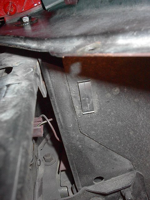

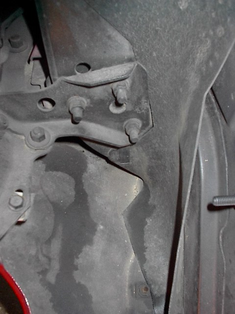

Bjorn, do you have a pic of those installed? Mine was an original AC car and had the X panels. I made a set of filler panels to go all the way around the bottom and sides of the core support. I've also filled about every hole and crack on the front with insulation, testing to see if ti made a difference, nothing yet.
Only thing that seems to have helped so far was adding in the "trapdoors" to the fan shroud.
I do somewhere, but I lost my register of where all my firebird pictures were/are...only picture you would need is the rubber fillers ,as the X fillers you had...you most likely then also had the metal lower baffle.....I`ll look and see if I can find picture(s)...
stumbled across them fast....not sure they help much as my pictures aren't of the fillers really , only on how they were attached...hope they may help you
in the first picture you can see the plastic Chrysler headliner clip I used to fasten with, the third and fourth show the original clips I still had in the holes of the missing rubber filler (originally called "masticated"

Thanks, looks like I got it pretty close then. I used some leftover ABS plastic and cut it to fit.
