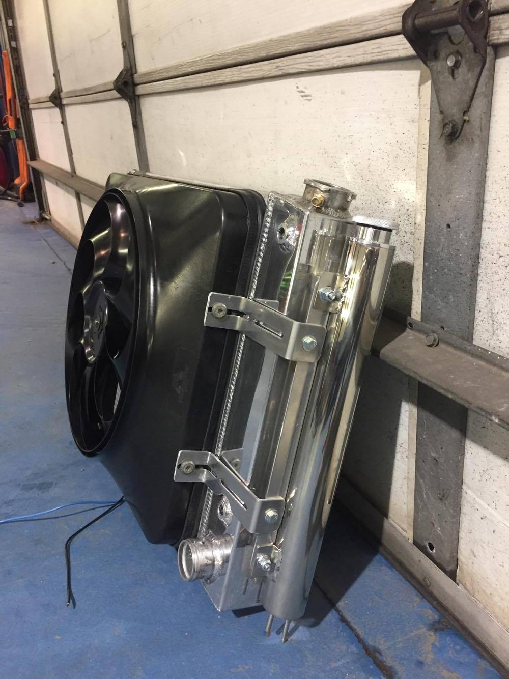

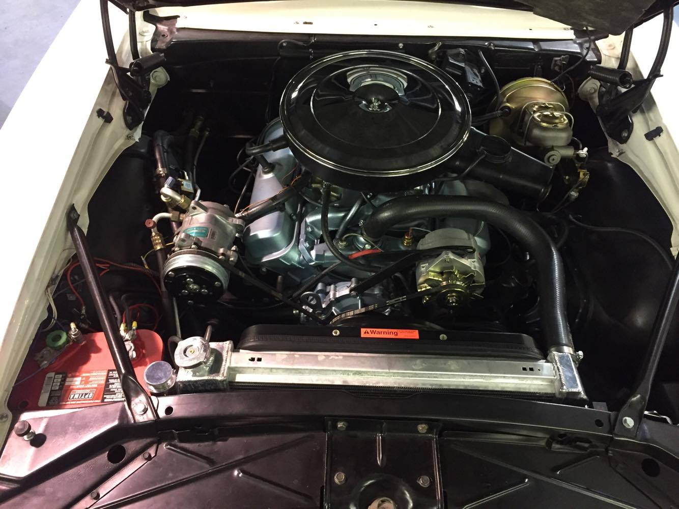

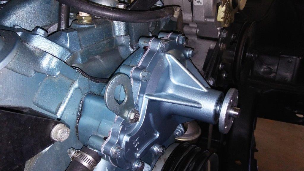

New high volume FlowKooler cast water pump New stainless divider plate with gap closed to .118" (it was .380" before adjustment) New Flexalite Extreme 180 3,300CFM 16" electric fan, with built-in shroud and seal (very nice!!!) New stainless recovery bottle/tube mounted to radiator (there was no recovery bottle before) New wiring and new relay set at 180 degree fan start New higher capacity alternator to support larger fan New Optima battery Timing adjustment....it was way off 1/2" carb spacer/insulator
After heating up the garage to 90+ degrees and letting it idle/rev for about 3 hours, it's running nice and cool now. It never got over 185. Ready for use this summer!!!! Thanks for the advice. I used a lot of the suggestions.
