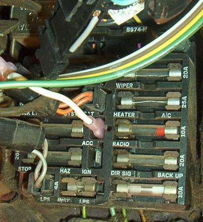

More specifically I have power to the starter solenoid but thats about where it stops. Fuse box problem? Does anybody have a picture of a original complete fuse box? Could a faulty neutral safety switch cause this? Hooked up a battery and I have nothing, no lights, etc. with key in "on". Battery is grounded to the intake manifold and I put all new ground straps in.

On the fuse box do the male terminals labeled batt, acc, ign etc connected to anything under the dash?
Posts: 6,158 Likes: 51
Posts: 6,158 Likes: 51 |
Standard BAT, ACC, LPS, etc. circuits are hard wired in the fusebox. The male spade connector is just an add-on tap to get fused 12v+ of the specified function. Don't know about '67 but on my '68 they were only used by the factory for the clock option which had its own add-on wiring for the light (LPS) and 24/7 power (Bat). I assume there were other optional features that may have used them on other cars. I now also use them for power to my hidden audio lamp, power, and memory using female spade connectors. Conveniently, when the factory used the tap for the clock, they used a splitter on a short wire stub so a tap was still available.

Okay thanks. Stock without any accessories those will stay unused.
