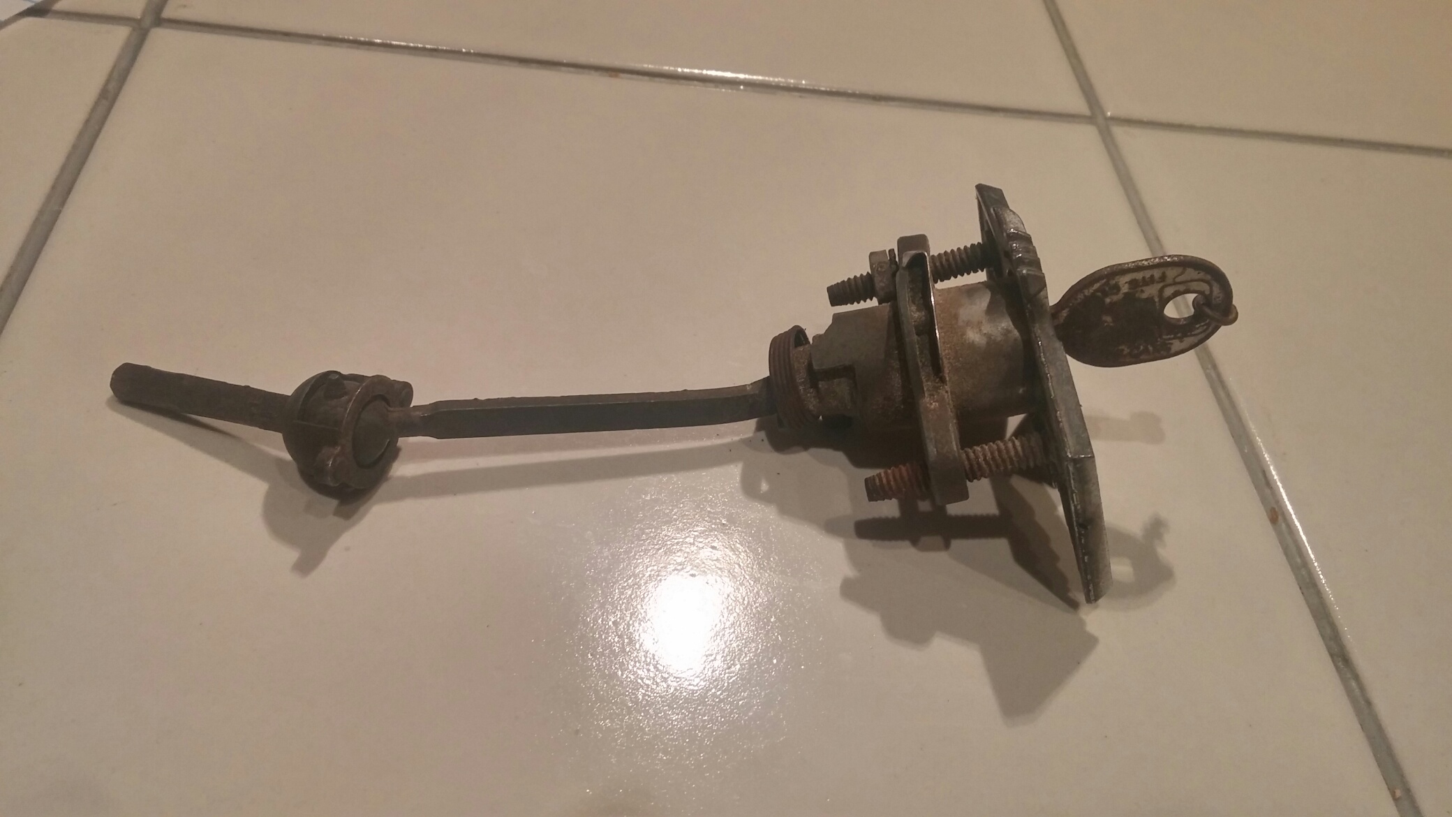

Interesting. I pulled my whole lock assy off a while back ago to do restro but I never had those two parts on my lock assembly and it fits and works perfertly. Hell, I don't even have item number 2 on mine. My tail panel is flat and the bird sits flush with it. I am wondering if something change somewhere in 69 as I have a very early 69 (Nov or Dec 68) and thinking maybe they changed it after that? Sorry I cant be of more help then that.

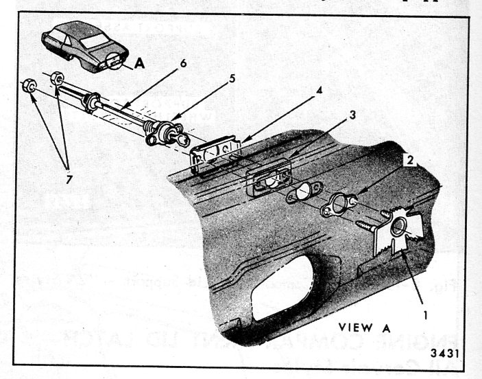

There is 2 parts inbetween the lock and bezel.otherwise the lock and bezel will move in and out when putting key in .maybe it would be mounted on a factory tailpanel but my repop is just flat sheetmetal and missing number 3&4 on the diagram.thanks for trying guys but if someone pops there trunk and looks and see a square plate on inside the lock sits against plz send me a pic maybe ill fab something up.
I don't think mine has 2,3 or 4 unless 2 is a gasket.II have the setup Bill shows the picture of. I have an extra latch assembly I can look at tomorrow. PS. Bill, how was the grand canyon?

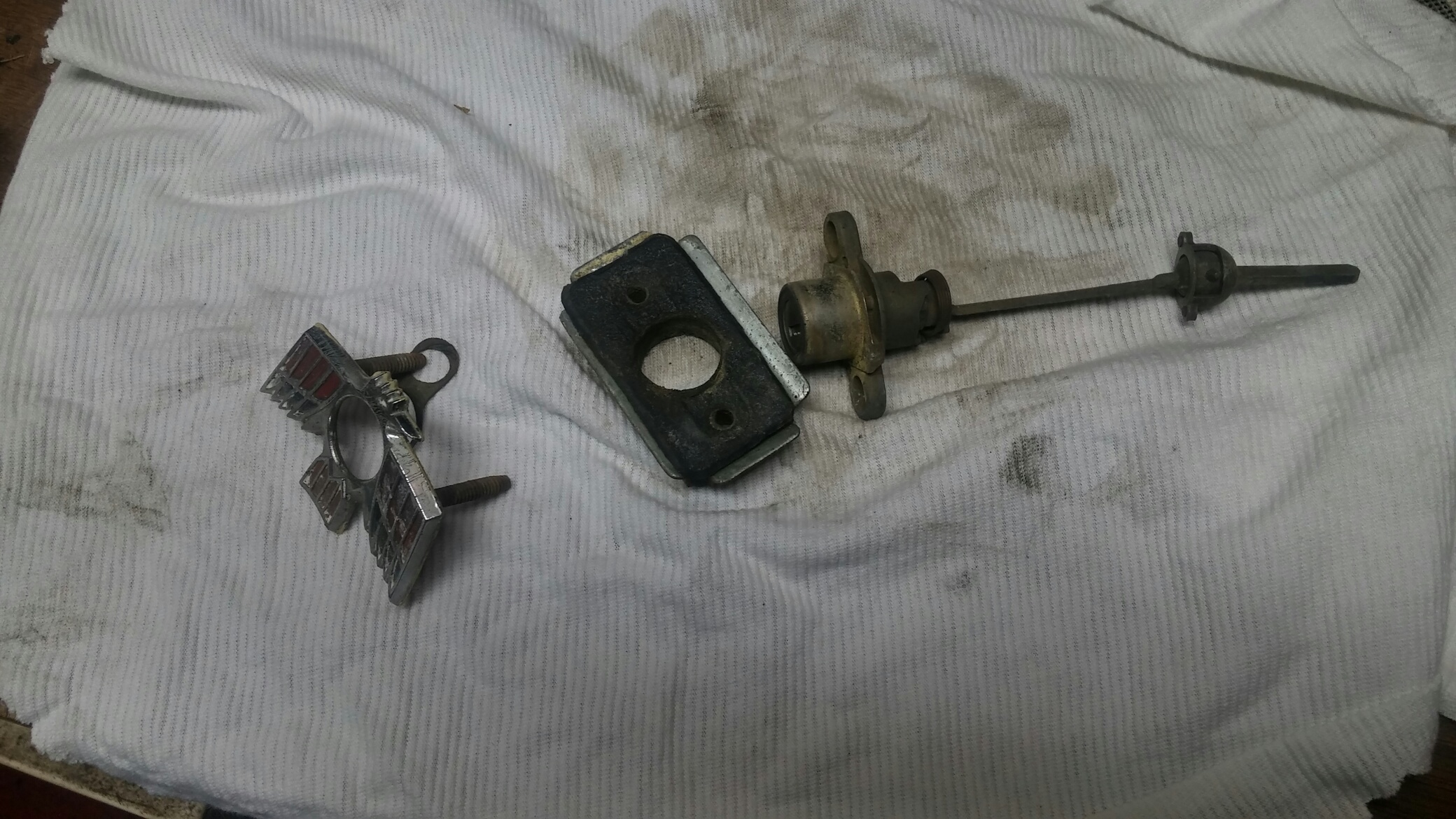

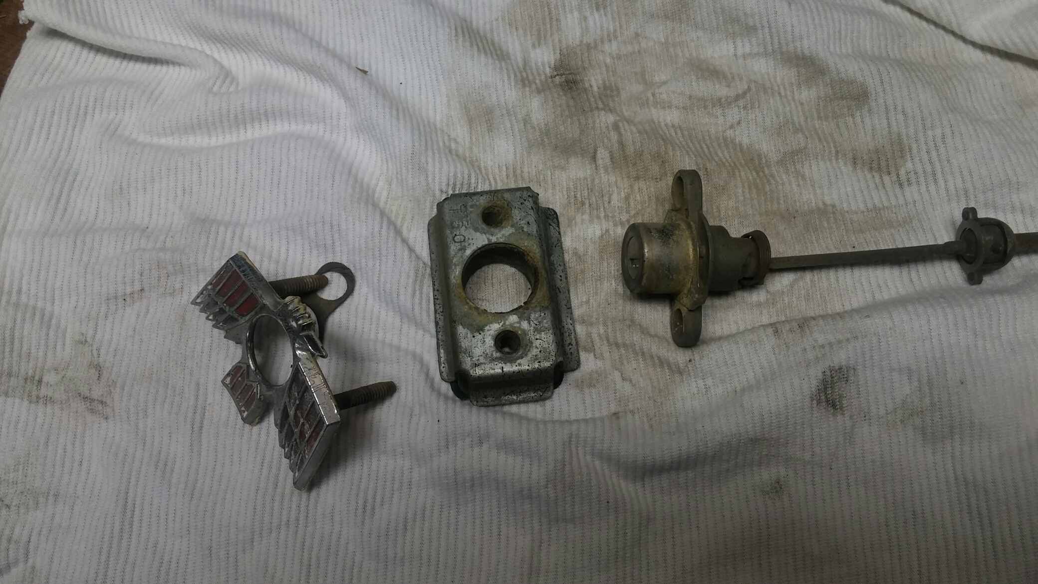

took ours apart and yup there is another 2 parts as jim showed in his pic. The 2 parts are a combo, a housing Metal piece in a rectangle shape with a foam gasket that fits inside of it. It was stuck to the tailpanel when I took it apart. if you had to, it could be made.
the part in the middle

The pic I took is the parts off the car as I disassembled it to look at it. The lock and the bezel came right out but, the part we are talking about stayed on the tail panel. as described above, metal with foam inserted. It was stuck on the tailpanel, I had to forcefully twist it to get it to "snap" off of the metal. Once removed, I could see that the foam had just got that sticky to almost appear that it was part of the tailpanel.
I can invision it getting thrown out with a tailpanel replacement.
