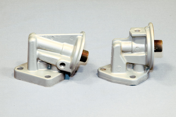

Thanks for the pic. You gotta use the one on the right with long branch manifolds and the filter adaptor or you have oil filter fitment issues
