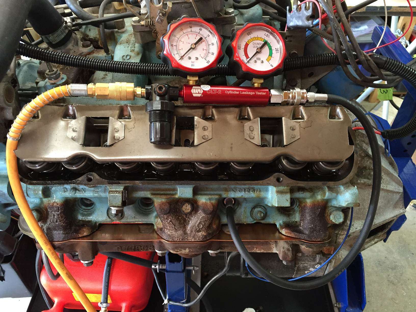

Have you considered doing a leak down test? That will tell you what is going on with removing any parts.
