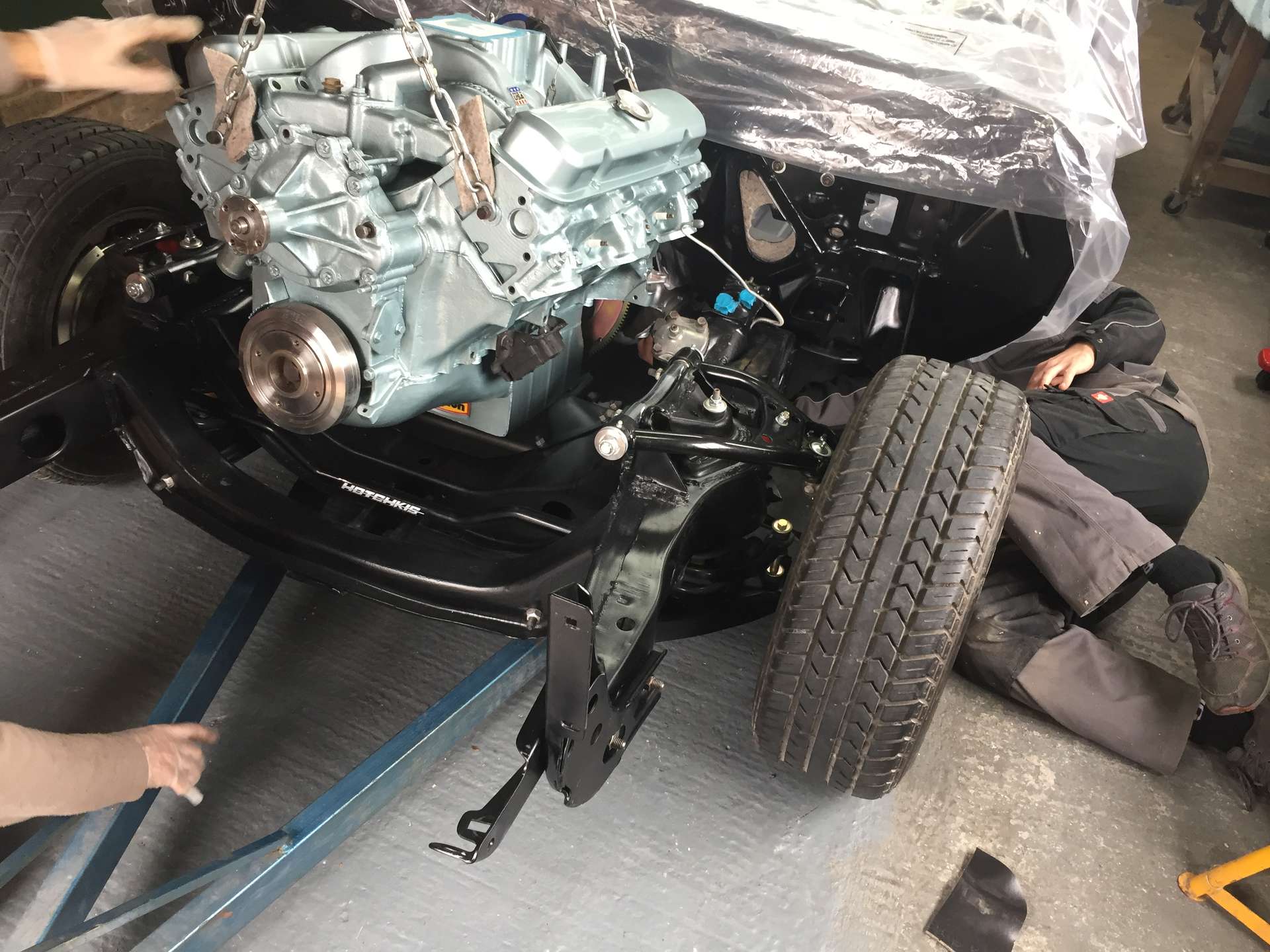

I think the oil pan may be wider than standard, should the inner tie rod ends pass in front of the oil pan ?
I will try and take some pictures later I have one that shows the engine going in I will see if I can post it

Looks like you have a Milodon deep sump oil pan and Hotchkis front end parts. Every time I've put anything aftermarket on my Firebird there has been a fitment and/or operational issue. Most of the front end stuff is made for Camaros and listed for Firebird. One size fits none.
