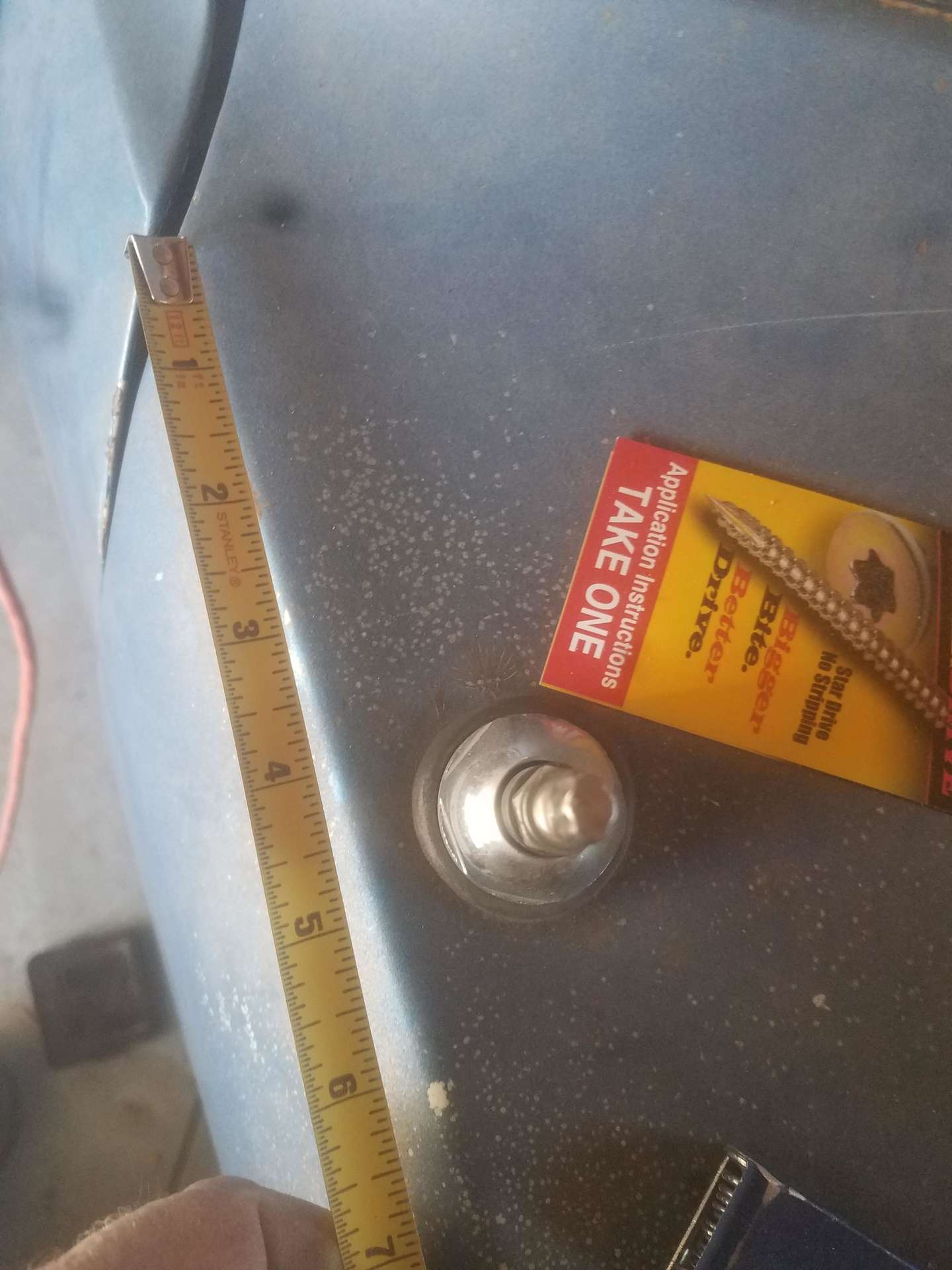

Does anyone out there have a diagram and measurements for the hole for the front antenna on my 67 bird?
I can't believe you would hald to buy something like that. I saw some templates for the right front fender but they want to sell them. Help would be appreciated

After looking all over I came up with a great plan. the front antenna is aprox. 4 5/8 from the door and aprox. 5 3/8 from the hood. hope this helps anyone out there. it is an 1 1/8" hole with a small cutout towards the center line of the hood about 1/8" square
