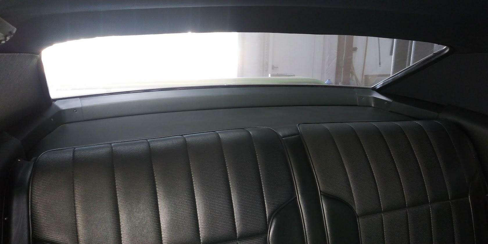

Maybe I am not understanding. Don't the '68 rear panels just cover the top painted part? And the '67 panels leave that bare? I am pretty sure the '67 panels were used by someone because they were available and worked. I would think just get some re-pop '68's and carry on. Or am I totally backwards on this? The pic is my '68 and my '68 panels covered the painted top. I think it's just a minor model year change. I am fitting a roll bar so ignore the mess.

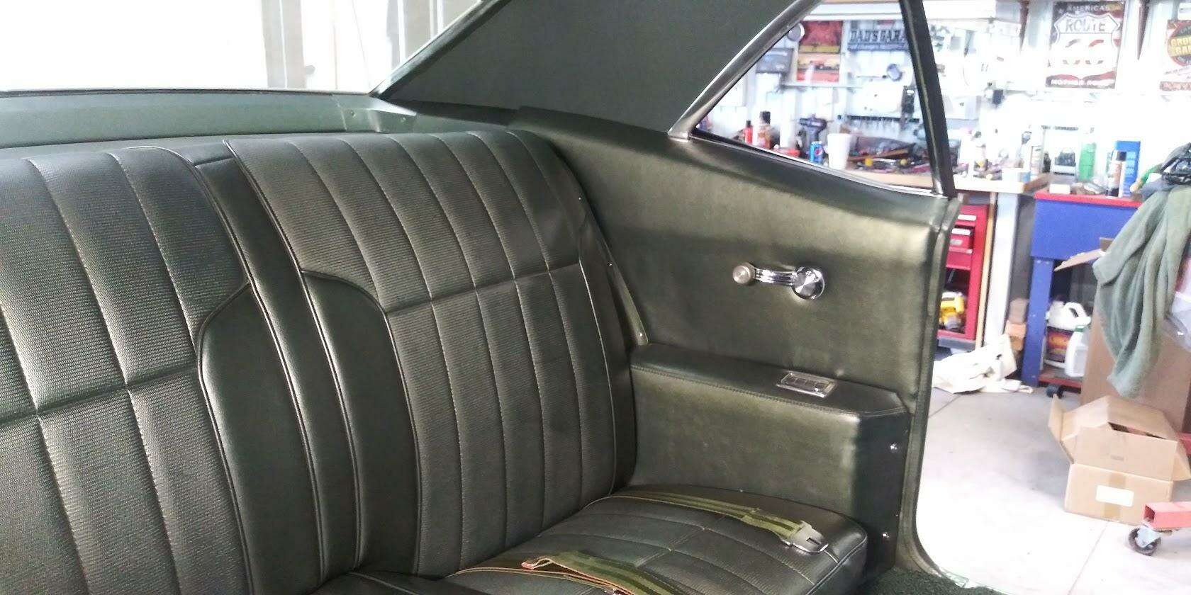

the metal there is right. the door panels fit over it. here is a pic of my 69, which should be close to your 68. sorry for the small pic, and for not showing the whole area, but you can get the idea. the other pic is what it looks like done. the door panels dont cover the whole area, the arm rests cover the lower part, and there is a metal filler piece for the upper seat. don't get confused looking at Camaro's as only Camaro's with deluxe interior will have the arm rests.
if you notice, the door panel ends at the back of the upper seat, the rest of the metal is exposed so it gets painted interior color, and there are metal corner pieces that go in the corners where it wraps around to the bottom of the window
Both my 1968 Firebirds had rear arm rests. One was deluxe and the other is base. Both had the ash tray inserted in the arm rest. I don't recall ever seeing one without arm rests.

If you notice I said only Camaros with deluxe interior, I didn't say Firebirds, I know Firebirds have the arm rests, I made that coment because most places try sell Camaro stuff as Firebird stuff
Sorry, I misunderstood. Still, don't the '68 side covers go right on over the painted top? Re-pops should work. I also had to order some '68 convertible arm rests from Firebird central. I needed the metal forms. I have '68 hardtop arm rests and thought I could modify them to work. After getting the re-pops I now know I was wrong.
