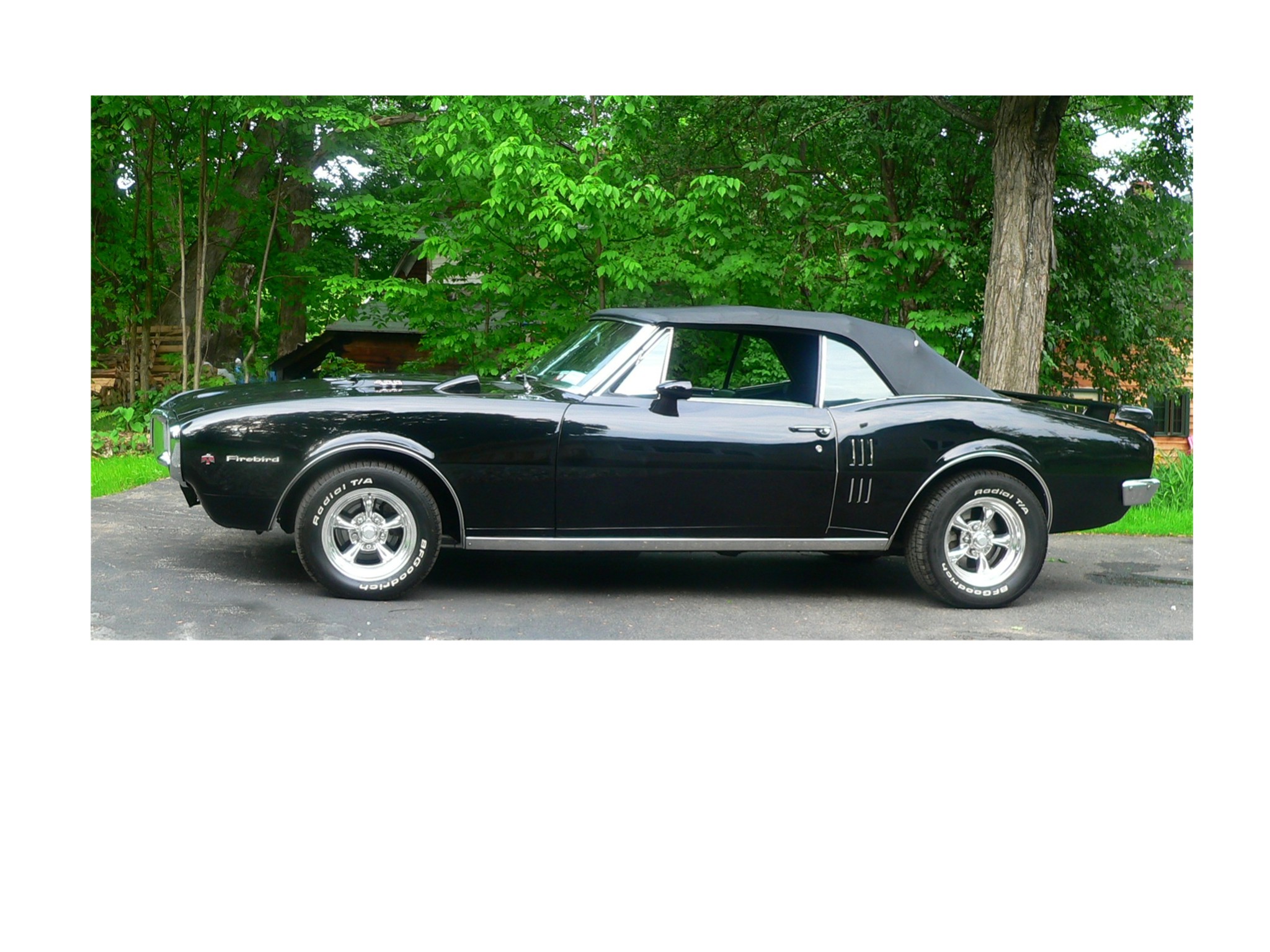

I just went to 15s (covered in another topic). I went with BFG 225/70/15 and I am very happy with the look, ride, feel etc. I think they fill out the wheel openings nicely. Just a note, the right front does rub just a bit if wheel is cut all the way to the right. The car rides much nicer IMO with the 15s. As you can see in the pic below I went black wall out and no trim rings (for now)...

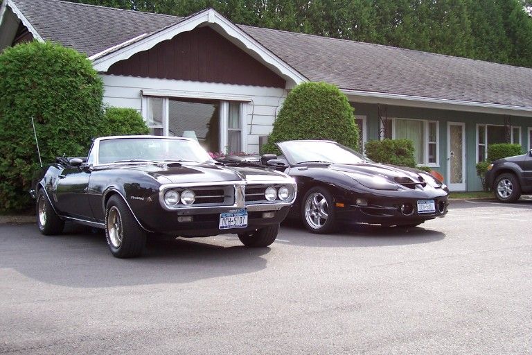

I used 15's on the rear and 14's on the front.
As seen in pic the front sits high with 15's(235-60-15)on the front.
second pic is 14's on front(24.5 in tall)and 15 on rear(26.6 Tall).
Helps keep the nose down at higher speeds.
