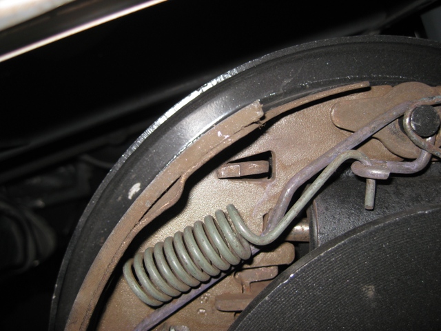

My axle is still out, but the brakes are assembled so you can't see a whole lot on how it's assembled unless the axle shaft is out and the shoes removed.
The top of the lever is inserted into the top triangle-shaped hole on the rear shoe.
It's dead center of the pic I attached. I know it doesn't help much.

And the link bar (under the wheel cylinder) has one wider end, it engages the parking brake lever also.
